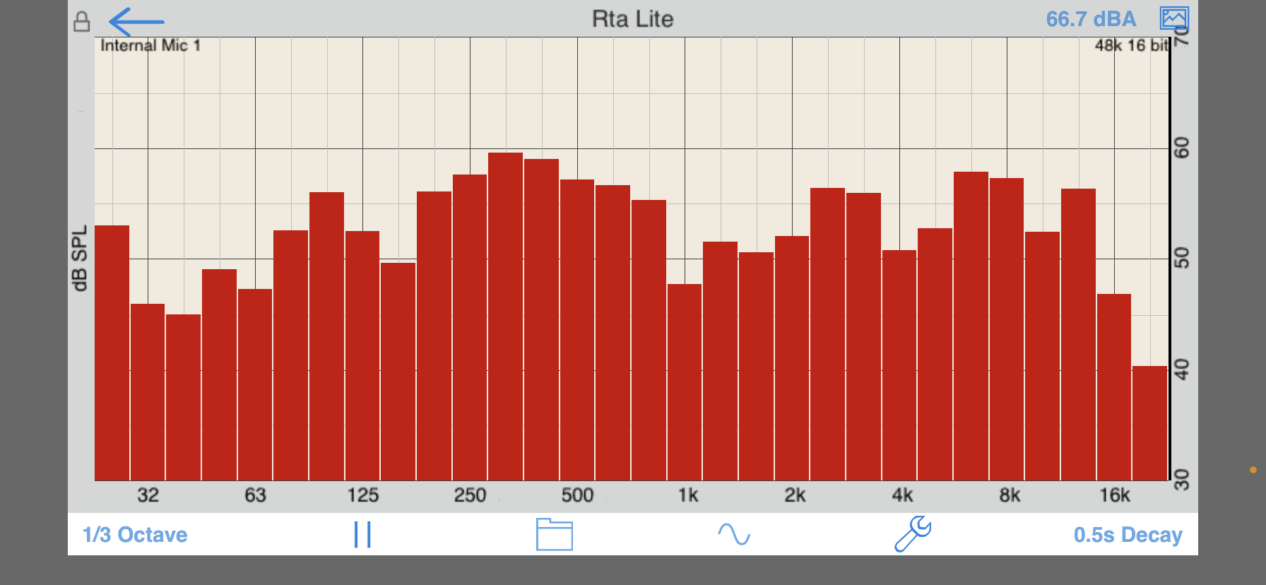

Agreed, after tuning I've never seen a flat response. I only ever used an RTA to get things flat(ish) with pink noise for a starting point and then went by ear using a few of my favorite songs. At least that's what I've done. YMMV
Also results tend to vary wildly depending on the tools you're using, even on the same bike with the same settings. Here is a couple of different iOS RTAs I tried on my bike. I don't use a DSP so I can't really do much other than play with the HPF on my LLs and tone controls on the HU (in this case bass and treble are flat).
AudioControl Mobile Tools
Audio Spectrum Analyzer dB RTA. This one claims to double accuracy if you pay to unlock (which may or may not be true). Regardless quite a difference...

I had similar results with same apps, even when using an Audio Control mic.
