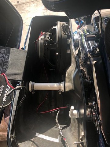

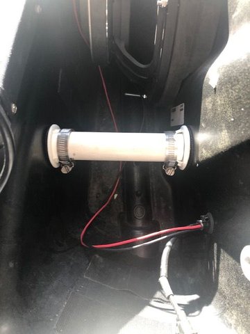

I reinforced my bags cheap and it works well. I used closet rod holders and 1.5" pvc pipe with circle velcro to hold them in place. I notched the closet rod holders so a hose clamp tightens them up snug. It cost me all of $4 and works well at least for me.

Joined: Jun 2013
Posts: 683
Likes: 85
Bob, that looks rather ghetto LOL but if it works!
Yea it does but will look better after paint. I just dont want to permanently mold dow rods to the bags.

I'd end up snagging something and tearing it out lol

Rob those were the prototype and I had to remove a bit of material around the latch but work well for the 10's in the rear.

Lately I've been using wood dowels wrapped in vinyl, and screwed in from behind the latch and to the ring, but could be attached to the inside of the bag for a rear mount speaker.
