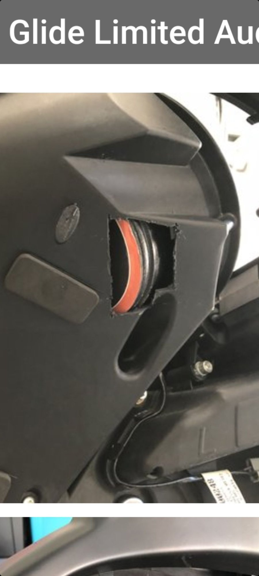

here's a pic

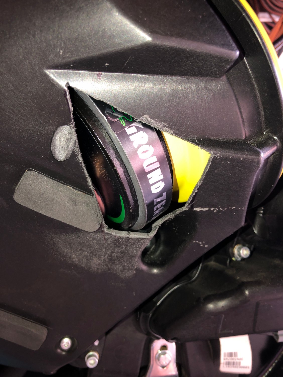

The GZ's will require a bit bigger relief hole than the Mmats. Just put GZ's in place of Mmats yesterday. Here's a pic....
