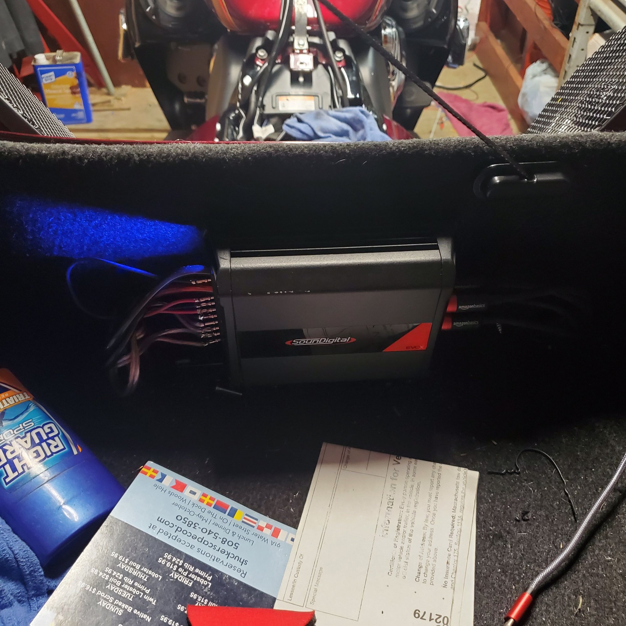

So i put back the 7.1 in fairing hooked it up to the SD 800.4
Put Kickers in the rear and hooked those up to to the SD 800.4
Now keep in mind i have 1 SD for up front and 1 SD for the rears.
turn the HU up and no cutting out of speakers at all.

I also was not aware that the SD amps don't have a fan in them like my 4180..i already installed 1 of them in my tour pak..am i asking for problems with it mounted in there.
i did it because i saw some installed in there.

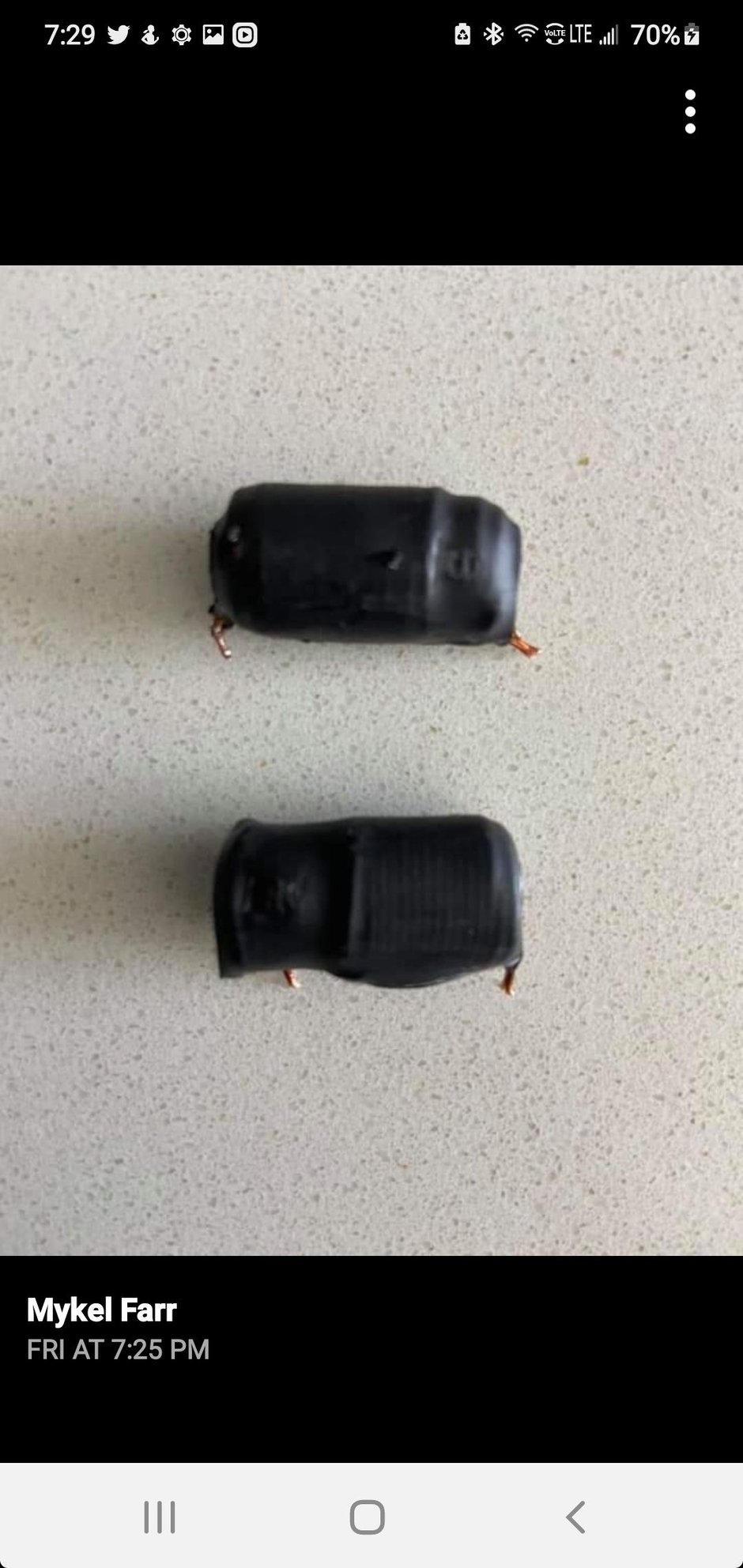

Given the hassle involved with returning the GZ's I'm inclined to try "cutting the coil" to see if it resolves the issue, but I'm not exactly sure what coil we're talking about. I have them hooked up through a DSR1 with the current crossover at 80HZ, equalizer flat.
Can anyone shed light on the coil cutting operation?

I cut the black looking cylinder like off.
and put them back on my SD amp and has seemed to solve the problem.
Let me find a pic i took and I'll repost.
After doing it thought you have to make sure to adjust the settings in the DSP as without it the speaker's dynamics have been changed
