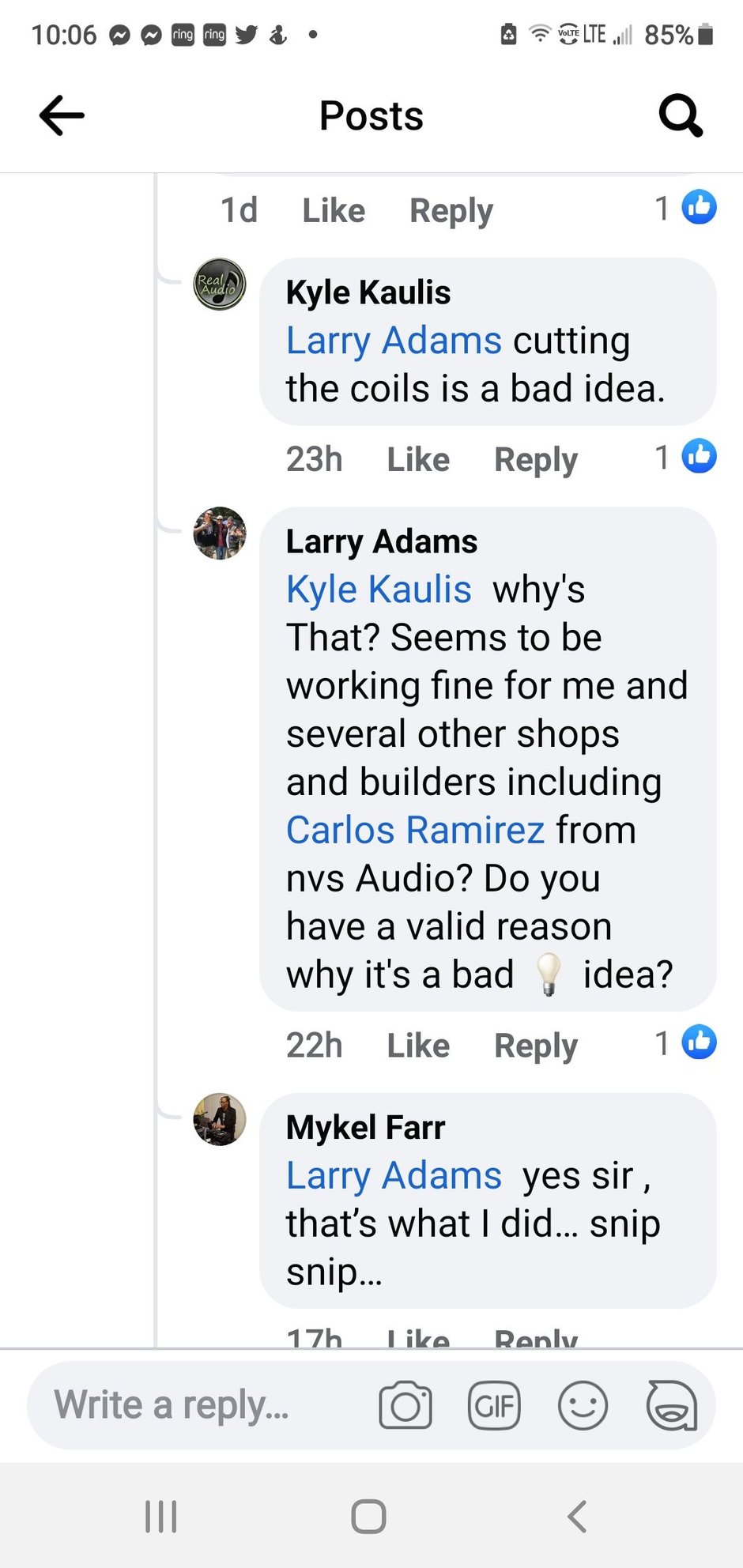

now i have been reading that some have had to cut the coil of the terminal for the problem to be rectified. GZ rep said he also has heard some cutting the coil but wouldn't recommend it as it would change the crossover to 6db which is not good for the speakers.
