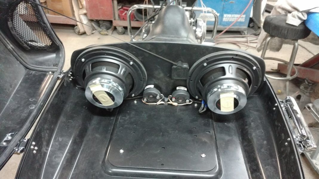

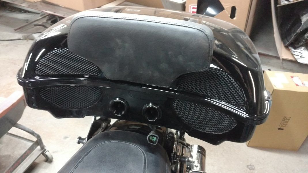

This is what I did for a customer that wanted more of a stealth look.
