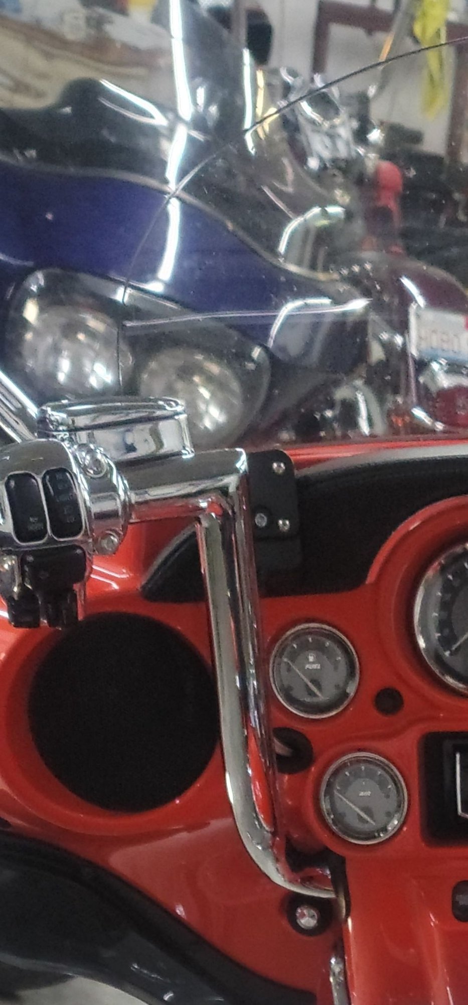

OP, to do what your wanting to do take off your outer fairing then unbolt the gps mount and pull the wires back into the fairing. Tie them up out of the way. Splice into the back of the cig lighter plug and add another cig plug to plug USB into. Run USB to the hole that had the gps mount. You may have to add a hole or slot (in the plastic) for the wire to come out.
Get on slip grip phone mounts and find a mount that you can make fit mount.
The photo shown is where I pulled the outer mount off a CVO so the bars didn't. If your handy you could do it in an hour or so.
