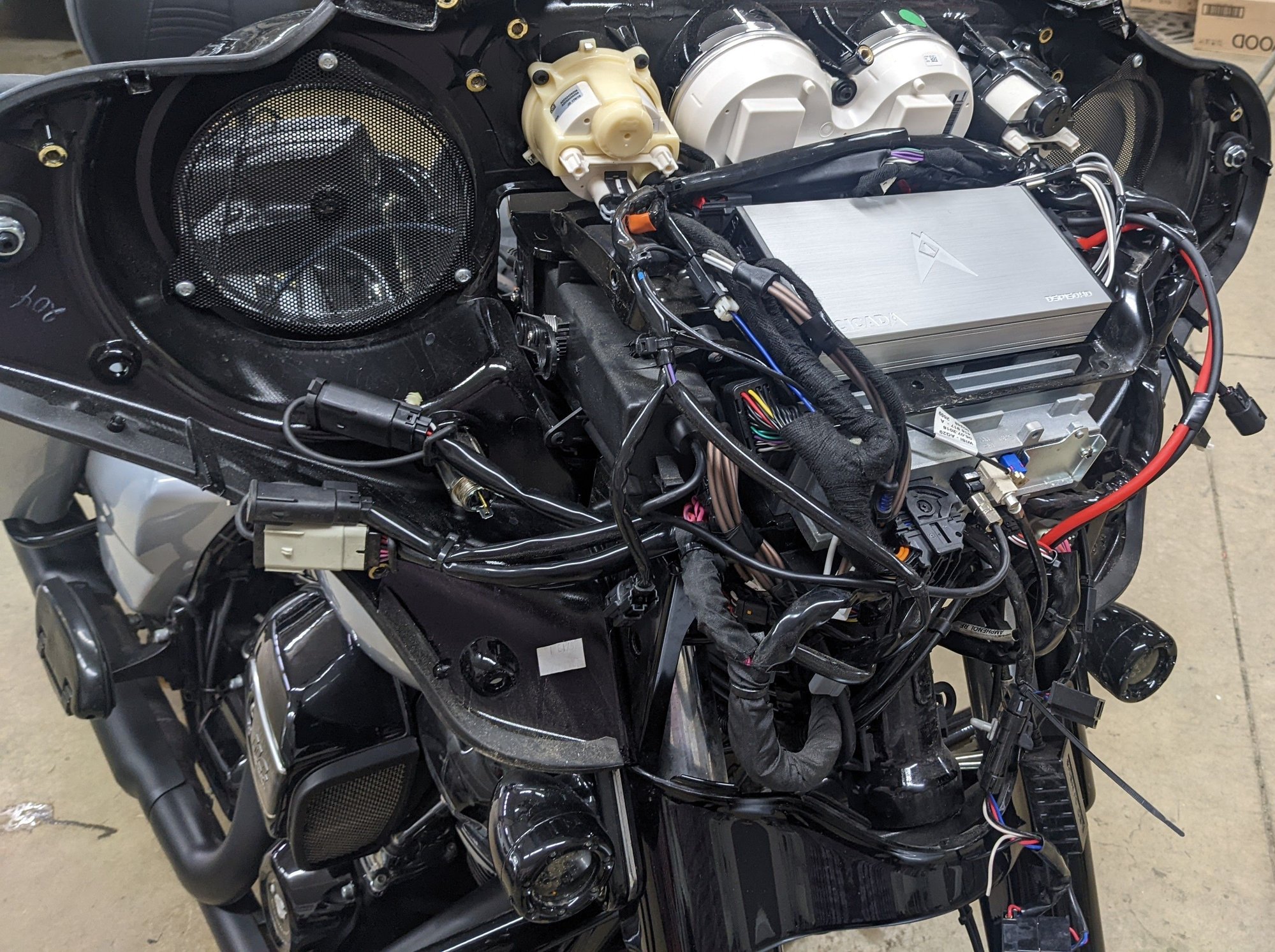

Picked up bike today, just before having to leave for work, due to some delays bike was a couple days behind schedule.
This setup is LOUD! It sounded really good till about 1/2 volume, and then it was really bright. I didn’t get into the DSP settings, but turned the treble down on the stereo and that helped. I was able to get to about 2/3-3/4 volume without making my ears hurt from the highs by backing the treble off a few bars on the stereo. I would think getting into the DSP could only help more. Not a ton of bass, but it’s there. Again, maybe the DSP can bring some more out?
On the freeway, full face helmet and I could hear the music clearly at 70mph at about 1/2 volume. I listen mainly to rock and some country and it was great. Off freeway, I was down to about 4 bars and it was clear, loud and sounding great. In driveway, cranked it full and it was loud enough (and still pretty clear) to be too loud, almost annoyingly loud. It is a night and day difference in sound quality and volume. I can’t say for certain this is the best setup out there, but if you want loud and clear (and currently a bit on the bright side), this is a setup to consider!
Installer, Sound Decisions out of Racine, WI did the work, and I am pretty happy with the quality of work so far. I was told that the system was set-up based on Cicada’s recommended settings for what I had put in (CH65.4 speakers and the DSP150.4D bridged at 4ohms). I was told I can come in and they can tweak settings for me, to get the sound how I want it. I am hoping that I can learn enough to use the DSP myself to adjust the sound.

I wish they took more photos, but this is what I got. I may need to pull the fairing off to get the Bluetooth connection going, I’m hoping it can be done without that. If I do,I’ll snap some more. I’ll post screen shots of the DSP settings they started with, if possible.
