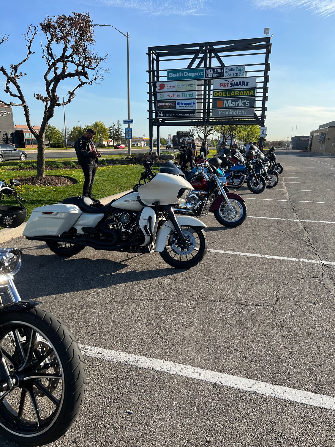

Hi everyone,
I’m the new owner of a 2018 RGS and I’ve been out a couple of times already this year and I love the bike and so glad I made the switch.
Im trying to connect my phone through Bluetooth so I can play my own music and I’m not having any luck and there are a couple of other reasons why I want to try CarPlay. I’ve been reading through and it seems that it’s not possible on my year bike but it is on 2019 and up. The other option is to switch the head unit, maybe a HDHU14+
I want to upgrade the speakers and add an amp and maybe lid speakers as well in the future.
Any advise and feedback is welcome,
