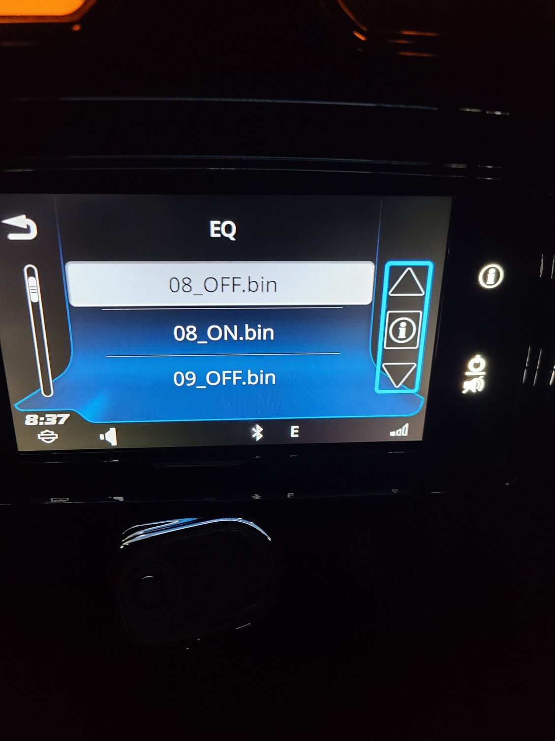

Here's the procedure to see what flash was used. RF should be 08_OFF.bin or 08_ON.bin iirc.
I checked mine...I have the RF flash so 08 is correct...
looks like I have those 08 files but not what’s loaded I tried to load one of the 08 files but ask from USB devices
As you scroll down the file that's loaded should be grayed out. It looks like you do not have the RF Flash and that's why you're getting that error. You could only see what file is loaded but you can't change it. It has to be reflashed through the data port with a Techno Research flash.

He didn't do it properly. The 08 file is the RF Flash. What was the number of the bin file that was highlighted in Gray when you checked your system?

Default 128_OFF.bin
128_OFF.bin

Originally Posted by websufer03101
128_OFF.bin
128 is not the RF Flash. I believe it's a Harley Flash. The error code you're getting does not affect anything. It's Basically not seeing the antenna but it is there. You could either ignore it or have it reflashed to the rf Flash and after they do it go in and check to make sure it's the 08 file that's highlighted. I guarantee the fault code will be gone
