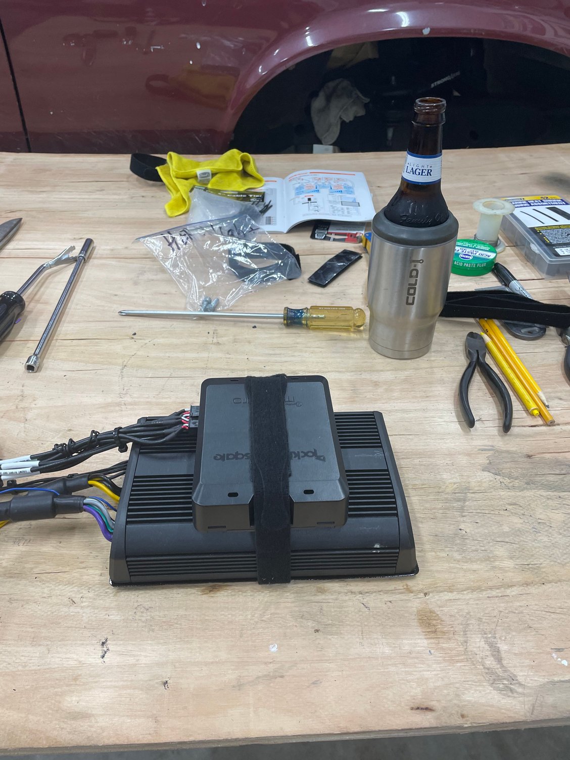

Let me start by saying I no audio pro by any means at all, nor am I nor am I much of writer.. lol. So we all know HD stock system suck so here we are.. so after little reading some videos I decide on New Hertz 4.900 amp ,Rockford Fosgate DSR-1 with Ground Zero CF6.5sPL & CF 69SPL yellow basket Speakers..
Well seeing the amp is so new that I couldn’t find anything on installing in Roadglide so this is just give next guy little help on what worked for me so far. Lol. There are no brackets that I could find or dealers know of that work for this. So pictures are worth thousand words..

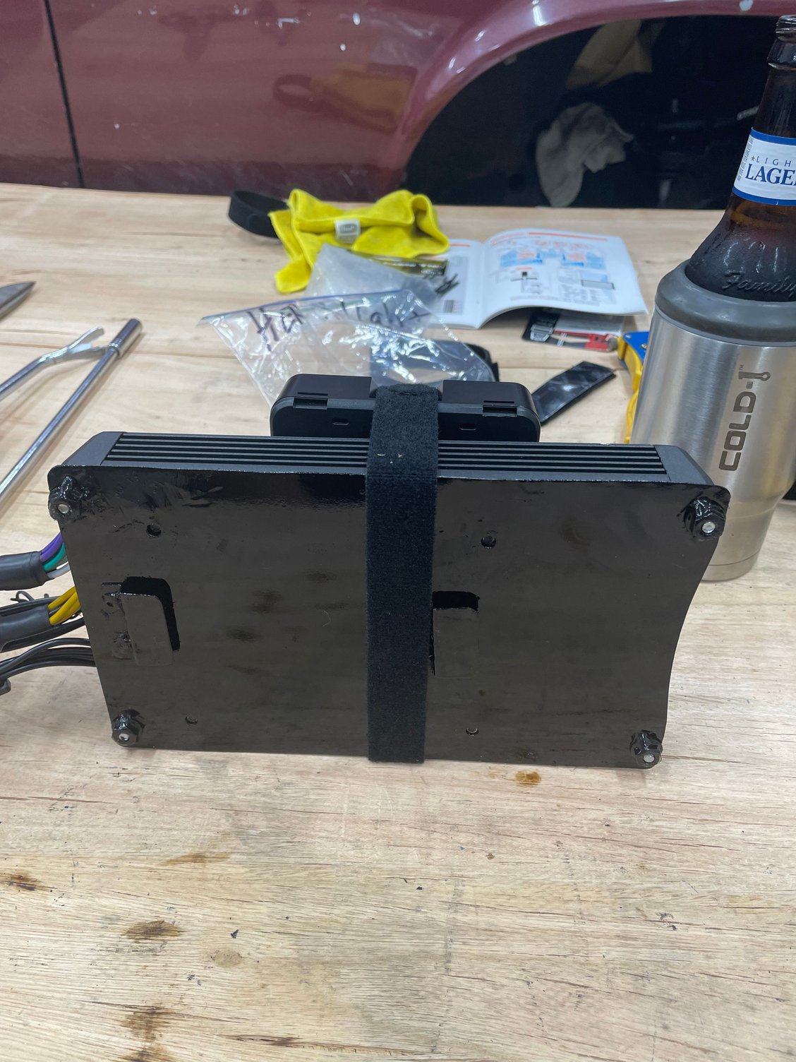

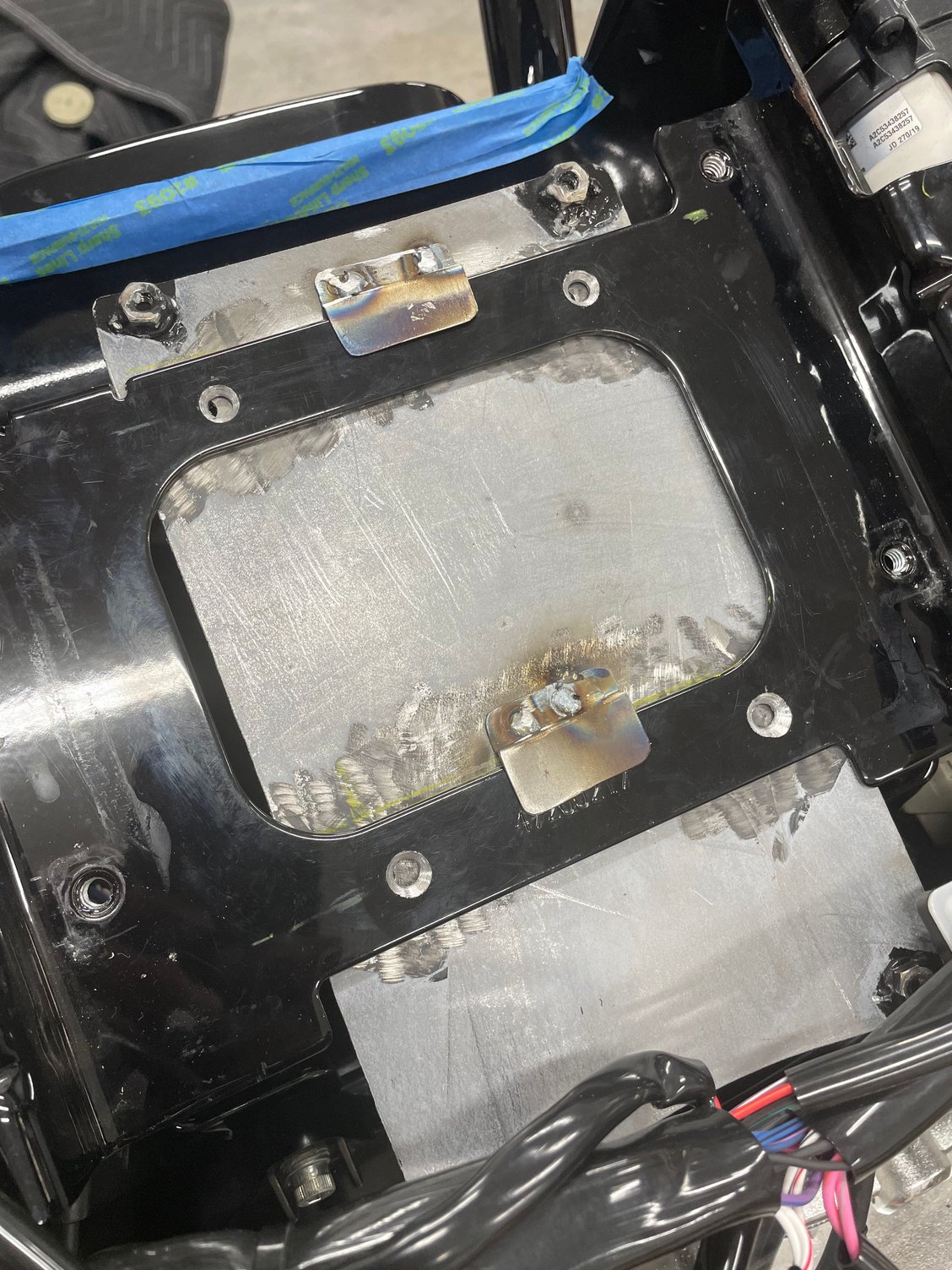

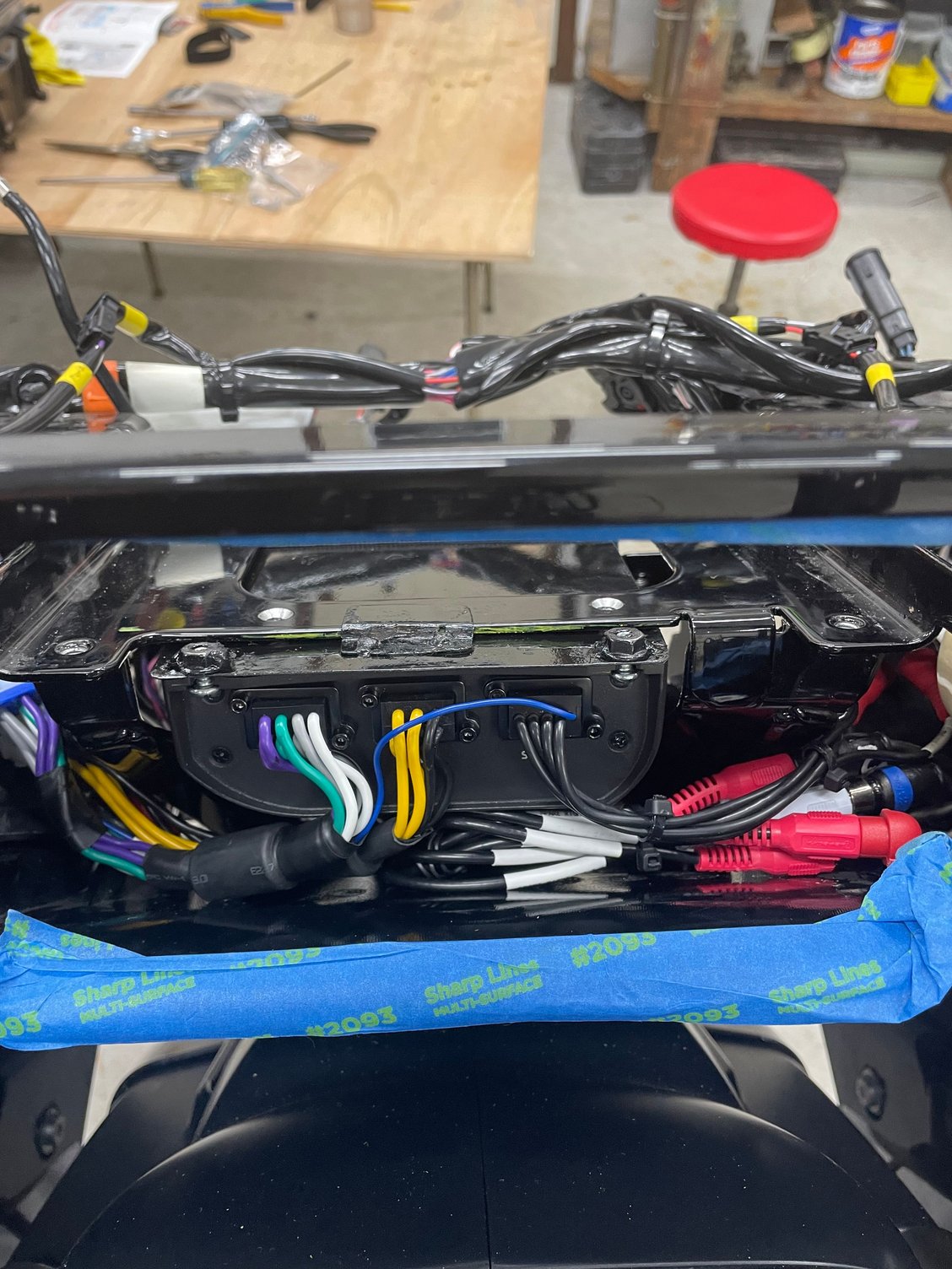

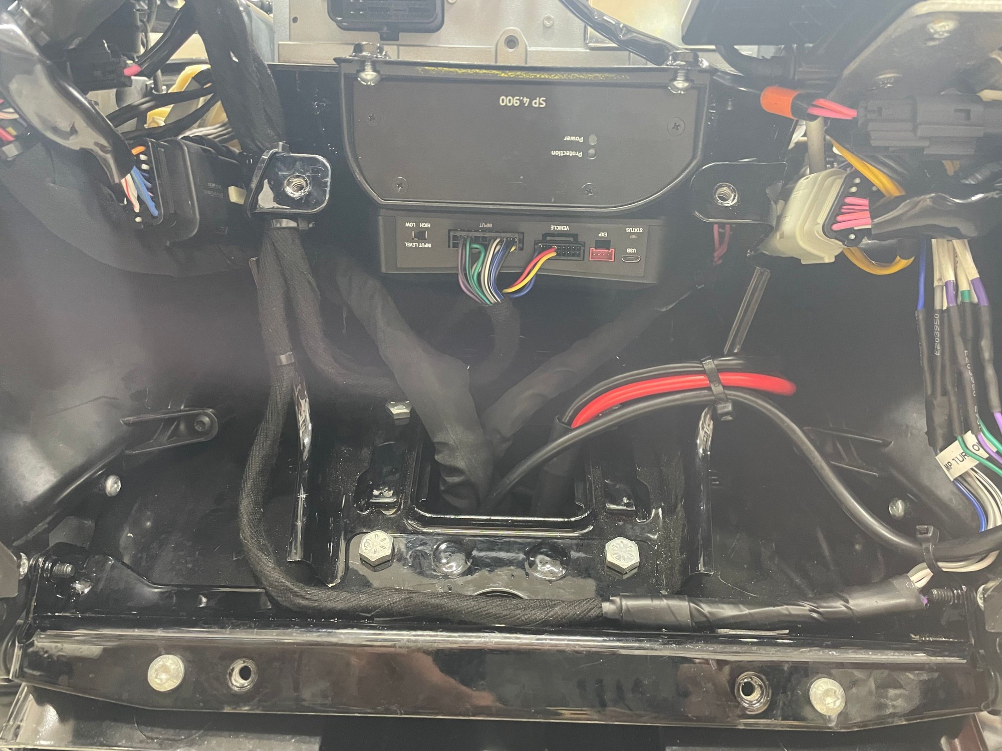

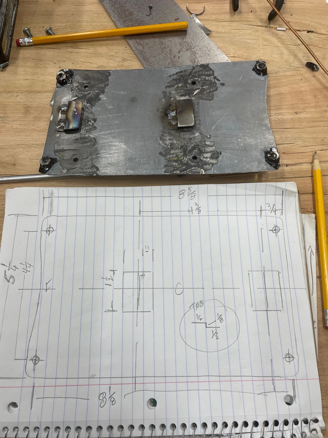

1st there isn’t much room to work with and no way to attach or strap/ Velcro amp into place. I did ver1 of bracket that was to bolt in but that 3/16” thickness of nuts use room that was needed. So ver2 idea was slide brackets.. The little bracket were PIA to fab with just hammer and vice but we managed .I did tack weld with mig but they could use pop rivets. As for DSR it’s only strap onto amp cause trying to get in perfect spot with Velcro prove to be impossible.. lol As for wiring I used channel on each side of radio bracket to run wires around.

I finished my install. I did heatgun to pods and had no problem installing fairing . I’m still fine tuning system but can tell you it sounds fantastic & did quick ride to test sounds at speeds 80mph. 👍🏼👍🏼. No even turn up a lot …. Thanks to Chris @ Garage Baggers Stereo

I should have added the sheet metal I use was 20ga which is available at your local Home Depot Lowe’s. And you can cut it with a pair of tin snips. And if anybody’s wanting to copy making the cliffs, I could probably do a short video on how I made the clips with nothing more than a vice, hammer and screwdriver.
