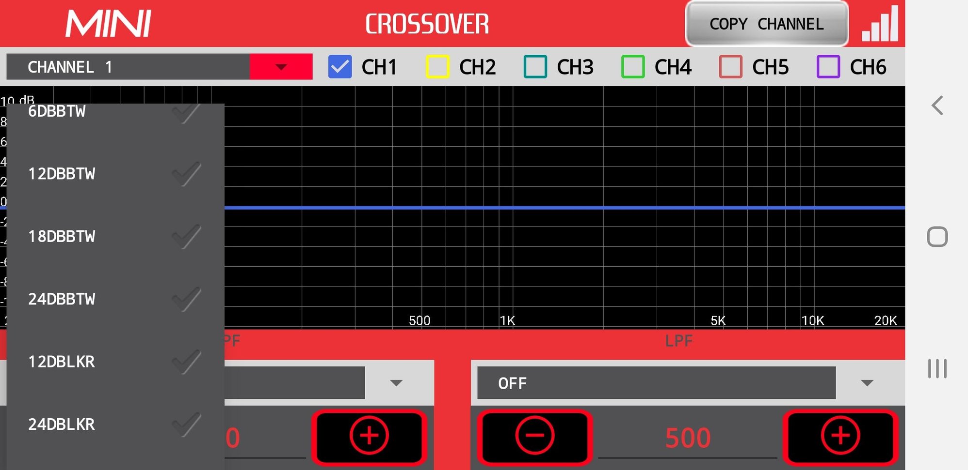

Setting up this new HKI dsp and need some help getting the crossover set up. Right now I am just running 2 Mmats 601CX in the fairing with a Stinger amp and I used the Technoresearch tool to flash the GTS radio with the 8 speaker 2 amp flash. Looks like there are several choices for the slope on both hpf and lpf and not sure where to set the frequency, the speaker is rated at 120 hz - 20khz but I see where some set them a bit lower around 80-95 hz? Any help would be appreciated!

I would start at 100hz, 12 db.
If it distorts, could try 100hz at 24db or 110hz 12db
Make sure head unit has bass and treble at zero/center.
