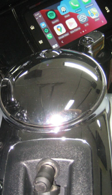

DRUM ROLL...DRUM ROLL....DRUM ROLL.
Just back home, plugged in my headsets and it worked perfectly. You guys were on spot. Exactly why I so enjoy coming here.
