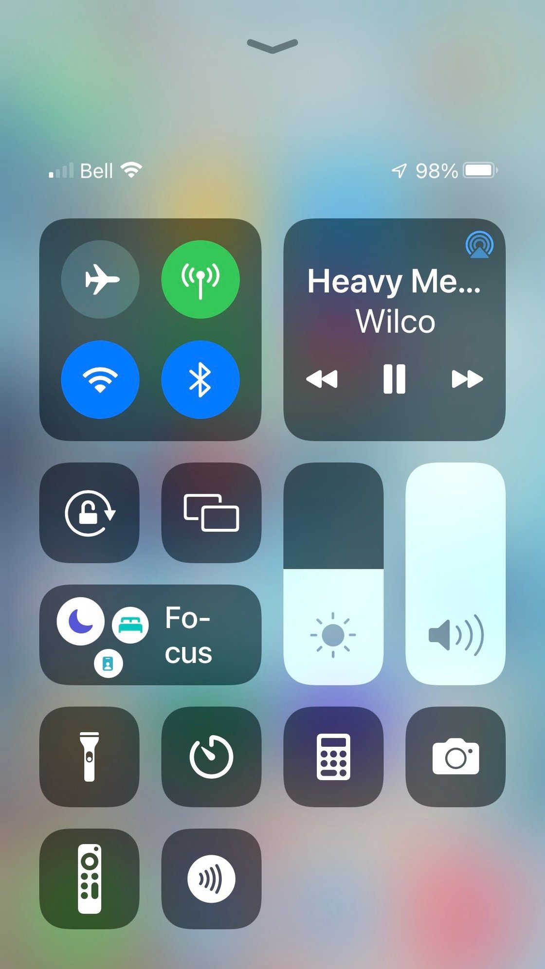

I've posted this in some other threads, but this is what it looks like for my iPhone (sorry for the big pics)...

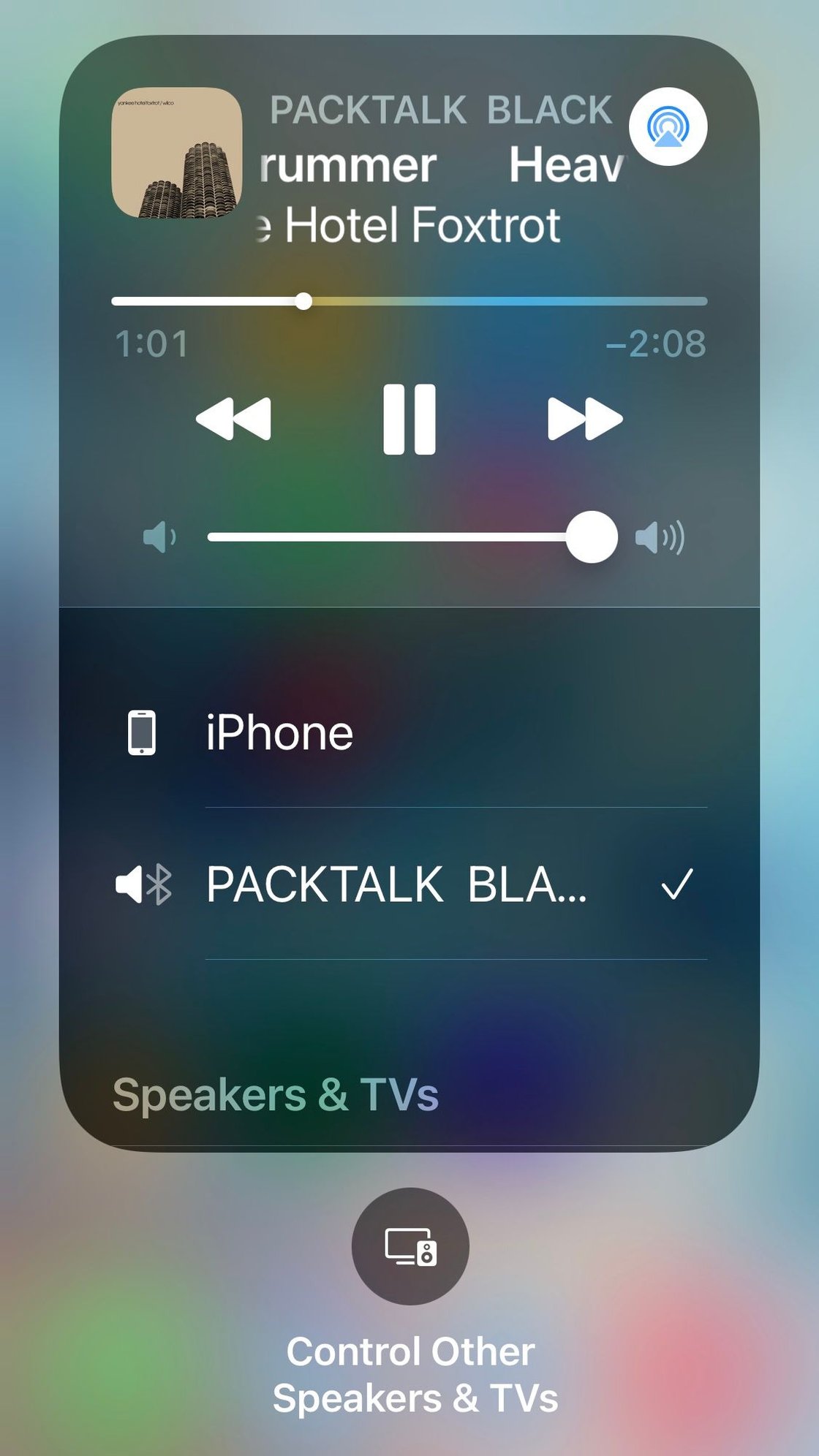

AirPlay (top right corner) screen on my iPhone....tap on that >
This screen comes up. Cardo PackTalk is selected/checked here so music to my helmet speakers...

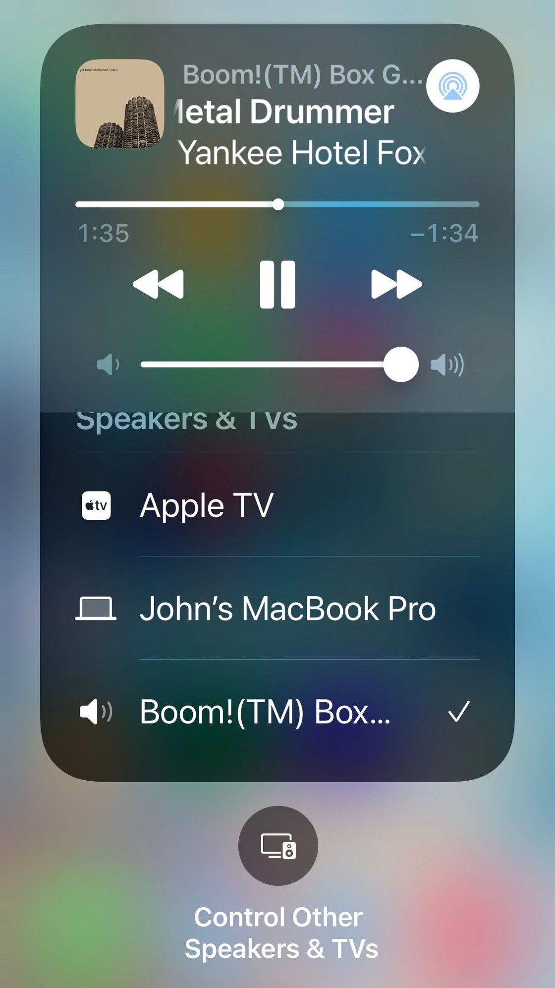

Or, Boom is selected/checked here so music to the bike speakers...
