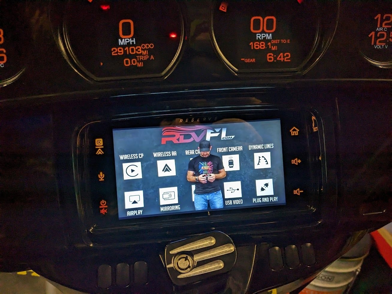

I got the RDVFL Automotive Technology – CP/AA – Mirror as recommended by Volunteer Audio, GREAT product so far!
its a wireless solution for Apple CarPlay and Android Auto, phone mirroring, plus access to Youtube and Netflix! Works with OEM and Soundstream radios that have wired CarPlay and Android Auto
haven't seen to many posts around the net about this product, but I'm pretty sure there are few on this forum with one
Anyone figured out how to exit out of Android Auto/CP and back to the modules homescreen?
seems to be a one way street going into Android Auto/CP. If I power cycle then it gets me back to the initial module homepage (so I can select say USB play buttons from the RDVFL home)
The reason I want to stay within the module is the use of joystick cursor control rather than touch the screen
Anyone figured out how to shorten the boot animation? or remove it totally?
while I'd be happy to have their RDVFL animation logo flash up, the whole multiple long winded boot screens makes it feel like the old 6.5GT forever loading startup.
I had a dig in the settings and found a couple of other animations, so I wonder if they could create a much shorter one perhaps?
...I've dropped the developer an email, but while I wait I thought I'd throw it out to the peanut gallery

once you enter Android Auto/CP this appears to be the only screen you can exit to

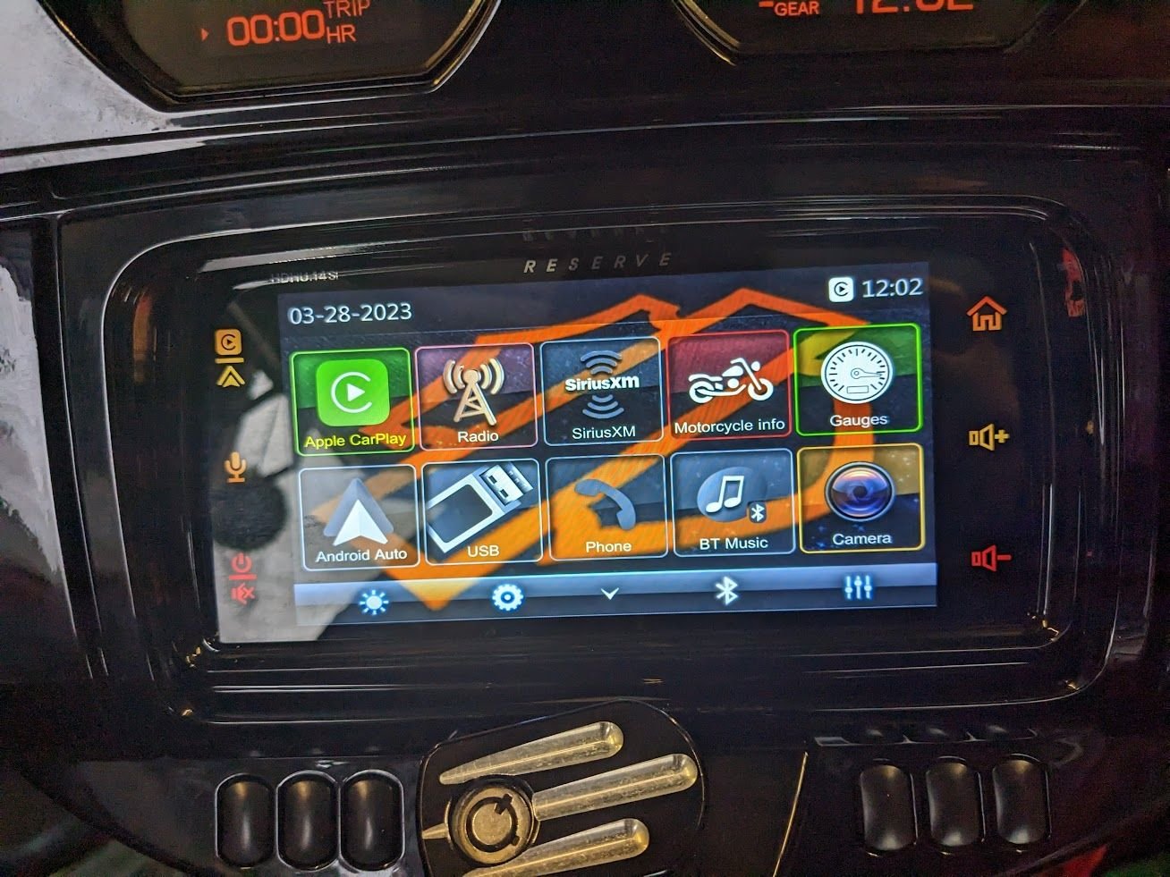

...and this is the HDHU.14si homepage BEFORE the module kicks in

when you first power up, you'll see PIC 3 and then the auto-boot sequence will select CARPLAY and you'll see the home screen on PIC 1 (I use Android Auto, but don't let that confuse you)
Now in the modules homescreen if you were to hit Android Auto/CP you'll enter the usual walled garden you know and love. but the problem I have is how to EXIT that garden back to the module home.
If you use the bikes SOURCE button, when you select CARPLAY, it auto returns back into Android Auto in my case (skipping the module homescreen)
hope that makes sense
MOTORCYLE INFO is the basic info screen of the bike (EITMS/GEAR/OIL/LIGHTS WORKING etc), and GAUGES, well that's the detailed gauge screen

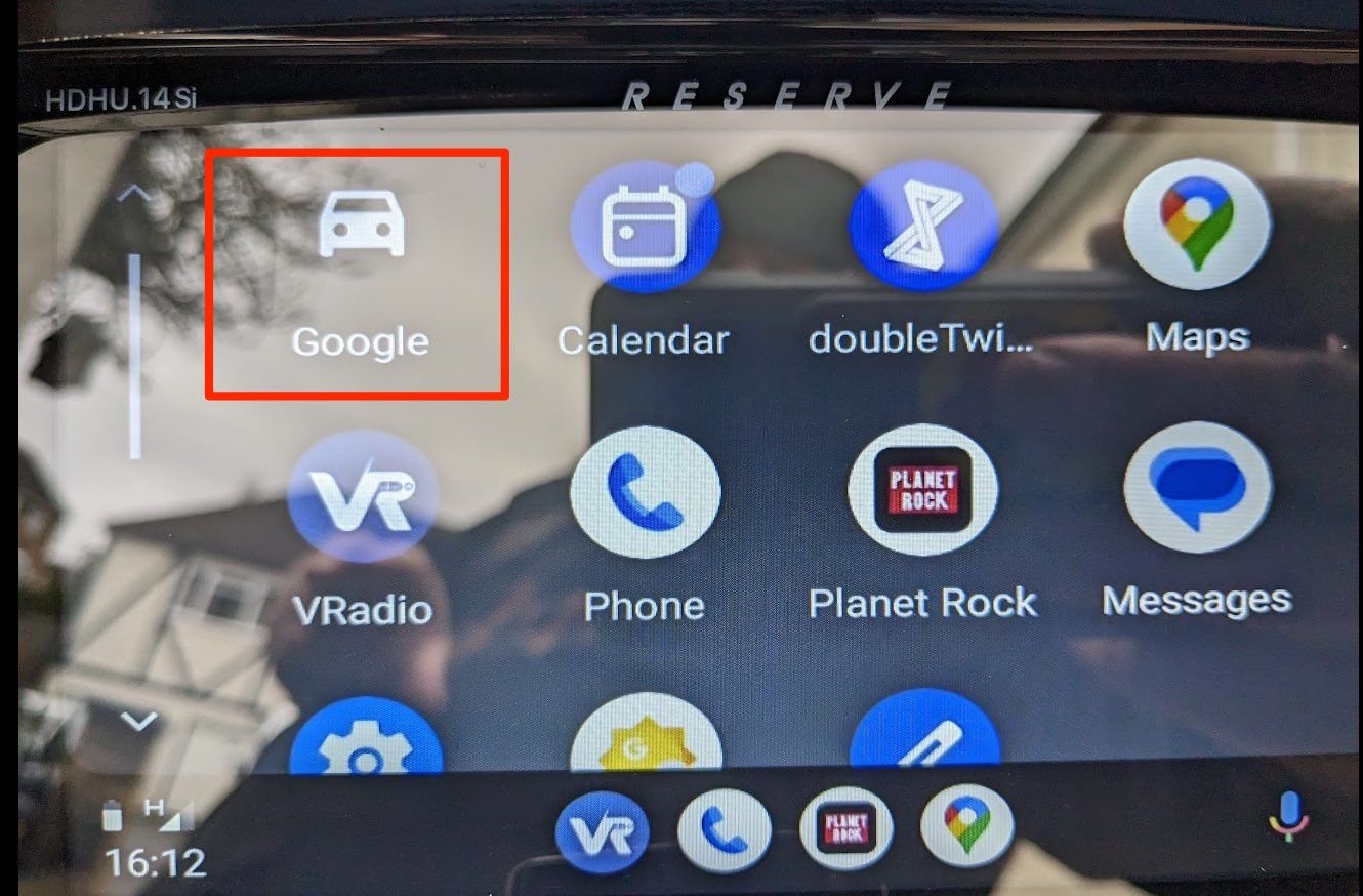

so to answer my own question, the app you are looking for is GOOGLE?!
that will exit Android Auto and return you to the RDVFL navigation screen
