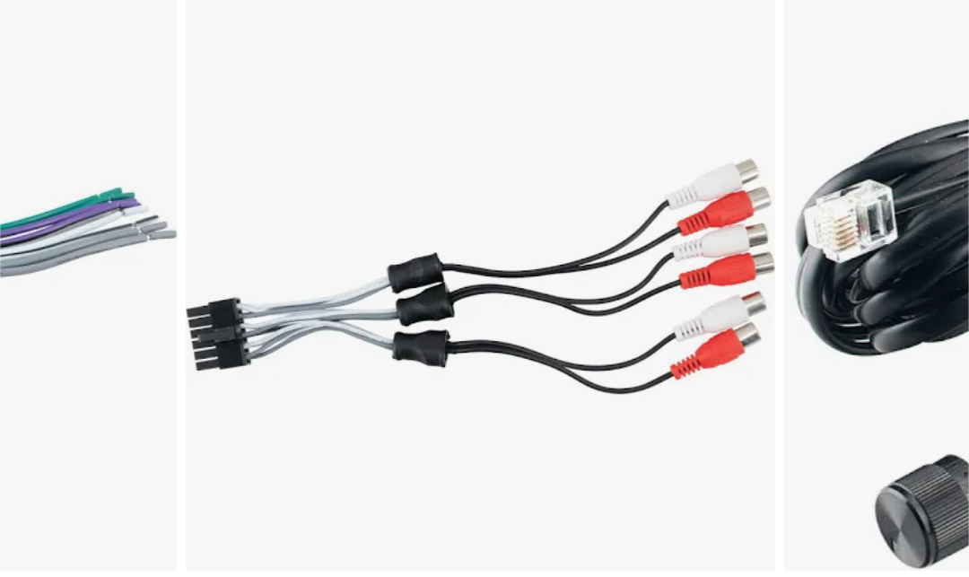

This might be a dumb question but I see there’s no jack for rca input on that stinger amp does it come with a plug that goes into the amp to a female rca jack? Or how do you wire from the pre outs on the aquatic deck
It comes with an adapter - allows either RCA or Hi-level input.
Now start doing your own research 😜.
