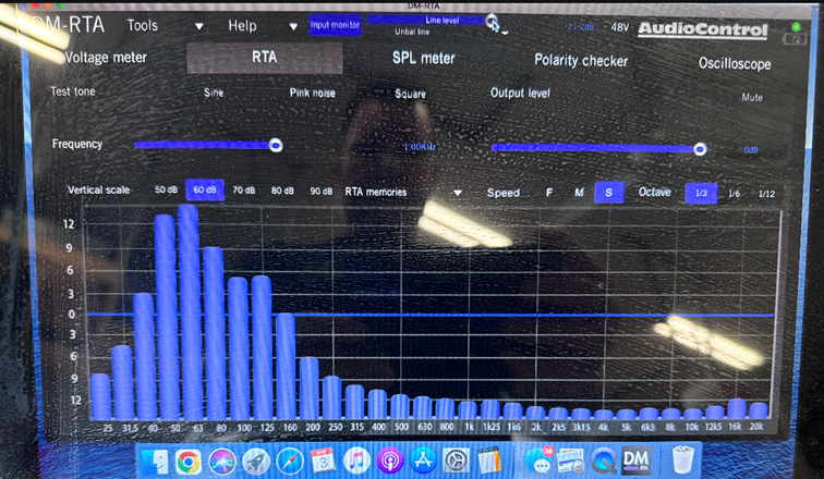

Originally Posted by Iron 1250
Agreed if this Rockford Fosgate '500watt' power amplifier was outputting a true 125watts a channel, however, it appears that on an independent test it outputs 80watts at 2Ohms and 38watts at 4ohms. As mentioned NVS are using a ARC Audio PSM Pro that has a maximum 16volts RMS input with success over about the last 9-10 months. I guess I'll need to look to either this or the Diamond Audio MSDSP66 apparently it can accept up to 24volts RMS. I was hopping to be able to recycle the Dayton for this project.
I have a kit from NVS that I was trying to install on a 2023.5 CVO. I did not measure the output, but Carlos did say it was about 22V. I know someone who used a Dayton, but it was on a non CVO.
I had a bunch of issues with the CVO I was working on that no one (Carlos, ARC tech support, etc) can figure out yet. I've talked to a few guys, with a total of over 15 new bikes and no one has had a turn on pop like this one. This bike has a nasty turn on pop (about 45 seconds after powering bike on, when the radio finally turns on) and it fried the "remote turn on delay" on 3 brand new PMS PRO's. I benched tested them, worked fine, but in bike and then delay would not work. This bike must be spiking something when the radio turns on. I ended up removing everything and keeping aftermarket 2ohm speakers in. It's louder, but owner still wants more. I just can't believe how bad that "500w" Rockford upgraded system is.
Here is the ridiculous Harley EQ curve on the new HU's
Thank you cshocker for the information in particular the RTA. The comment from Carlos over at NVS is useful to know too. The system designers at H-D really should take a good hard look at themselves. Should someone at the company I work for tuned a PA system like this the installation technician would get a bit of a talking too. Line array systems sound very average with this tune in their DSP.
I saw elsewhere in the forum you mention this issue on have with the turn on spike that has concerned me somewhat too. I hope that you are able to resolve the problem.
Apparently the non-CVO '200watt' systems seem to be outputting shockingly low figures so I think the Dayton would handle these okay. I just think that the '500watt' units are going to provide just a little too high a voltage for it to work with comfortably.
Once again thank you for the information, every bit helps. Once my bike finally arrives I'll start work on it and do a bit of a report on what I find.
