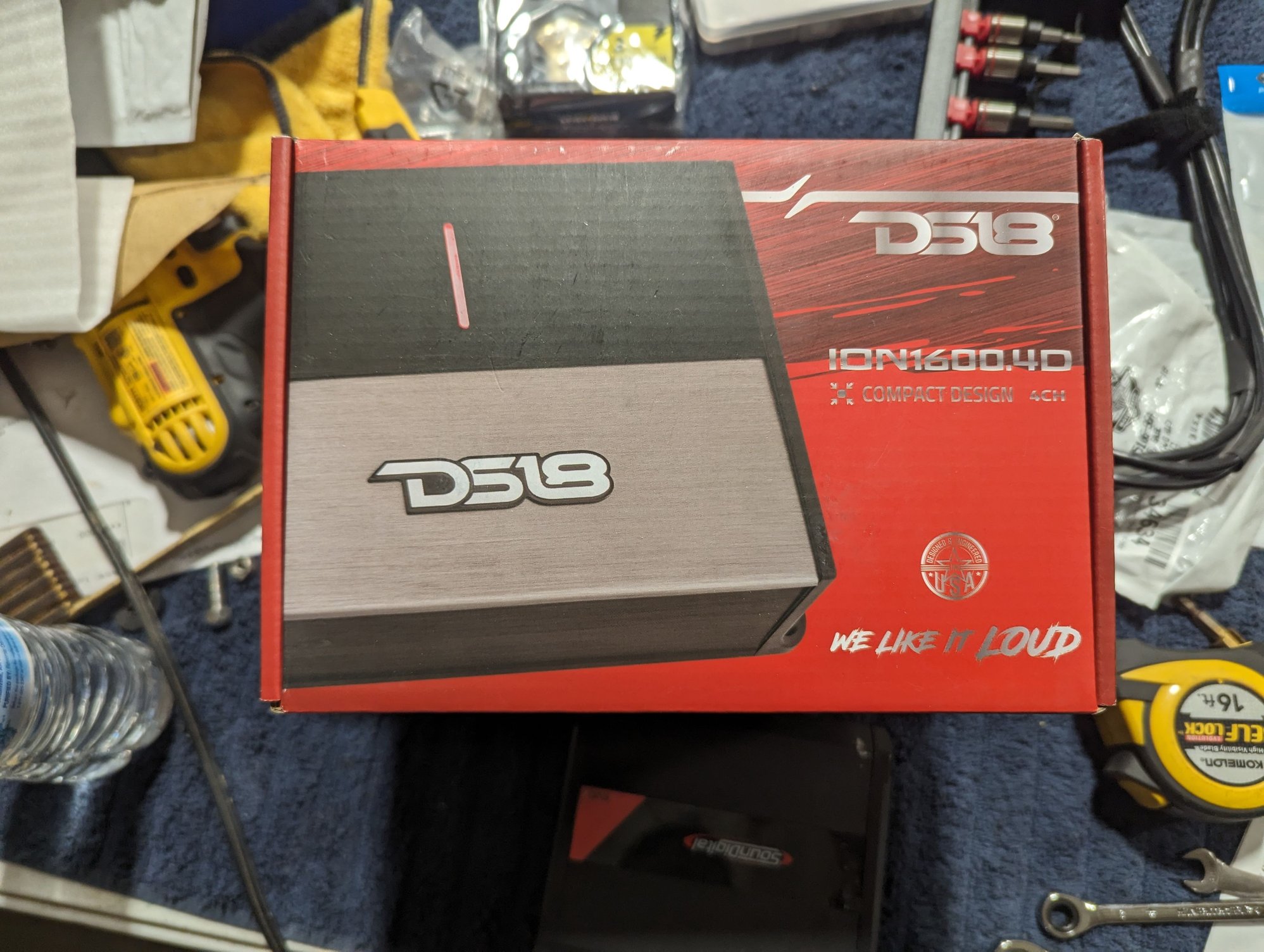

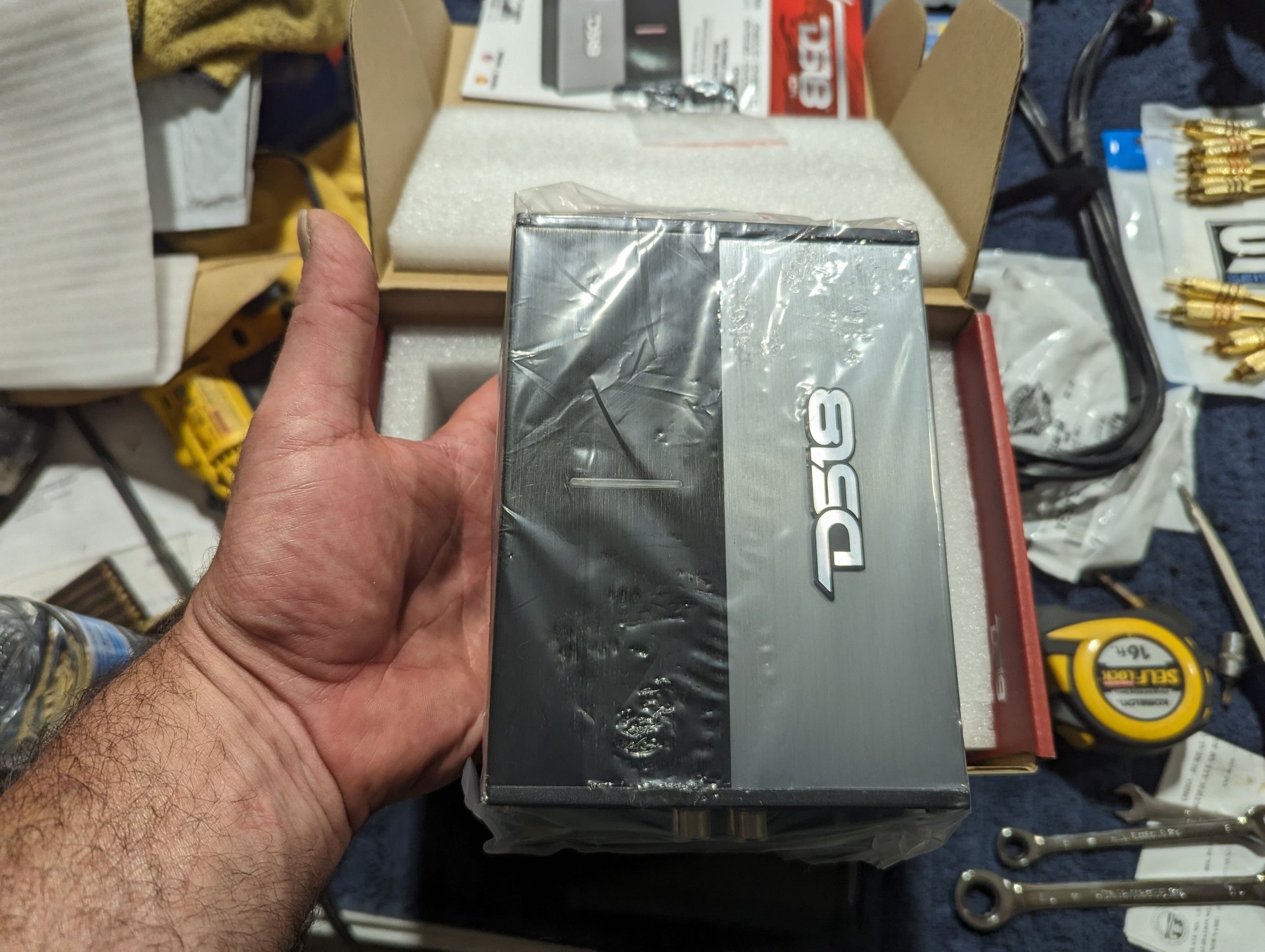

Amp arrived today. Hopefully by Sunday night it's in and tuned. I'll keep everyone posted. Unbelievable how small they can make them these days.
