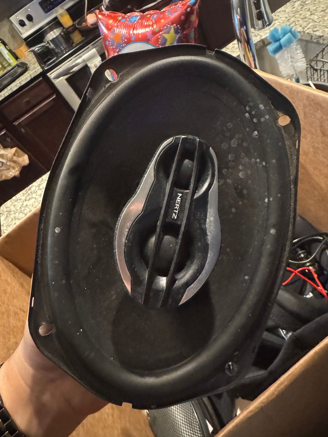

Ok, I can’t be the first person that this has happened to… my saddlebag lid speaker wires broke into because I fill the saddle bags too much and the cargo pushes against the speaker connector.
My question is in repairing it. It would appear that the white wire out of the magnet (which broke super short next to the connectors) just goes to the positive connector tab? And the black to the negative? It’s inside the plastic casing that I can’t get to open up easily but it appears that’s the case. So if that’s true (and stop me if it’s not). Can I just bypass that short part of the wire and connect the longer piece to its corresponding tab directly without the little piece? (Little pieces are too small to salvage.
It seems to make sense but I’m not a speaker expert so I thought I’d ask first.
thanks

Won't make a lick of difference, a speaker is nothing more than a coil of wire, it's not polarity sensitive.

Speakers are absolutely polarity sensitive. Reversing it makes them drive in the wrong direction and lose sound quality and oomph. You can even damage speakers by reversing the polarity. The voice coils can get stuck on their inward pulse and not return to the neutral position.
OP, yes, you can extend the wires. Just throw a couple spade connectors and hook them back up.

If you're concerned with adequately extending the wire, get yourself some heat shrink solder connectors along with a small bit of same gauge wire and extend them. Easiest way to do it if you don't care for regular soldering and shrink tubing.

Since the wires from the amp connect to these same speaker posts, couldn’t I extend the wires that broke from the speaker and connect them to those wires that come from the amp, which will then connect to the speaker posts? Shouldn’t matter since they are all connected anyway?
also here is the other side of the loud speaker if that I do helps
