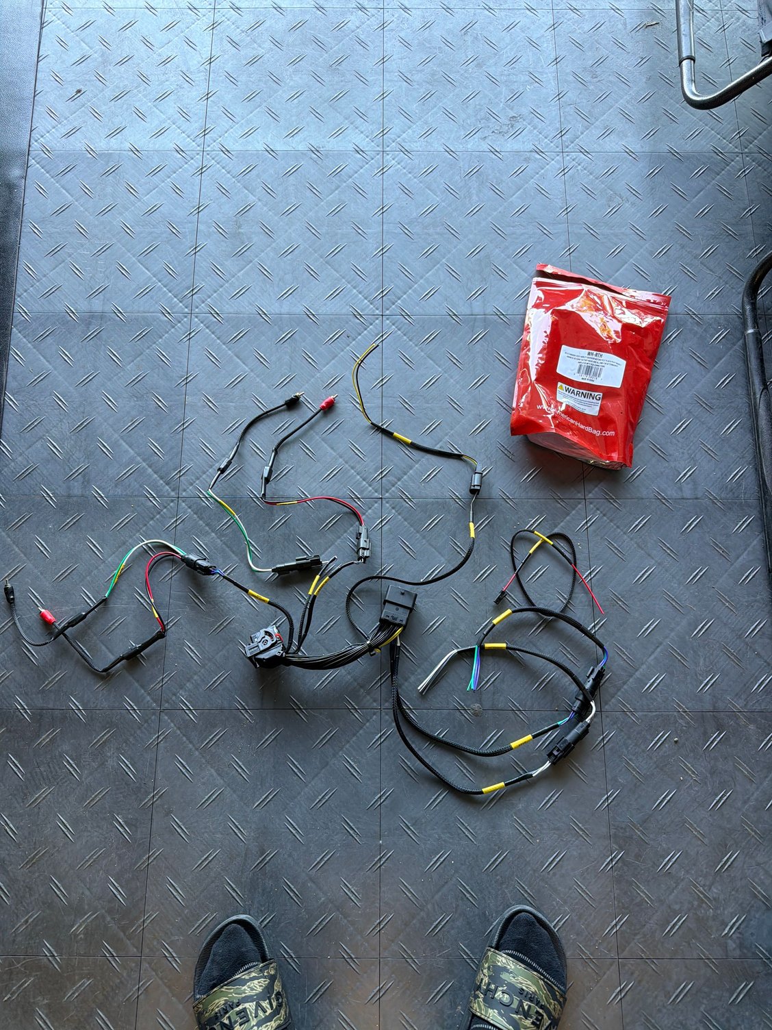

Upgraded my 2021 CVO road glide system with all new Cicada 6.5, 6x9, and Cicada amp. Bought the AHB Bypass harness for the left saddlebag to remove stock amp. Also a new T harness for the front. I’m getting sound out of the front speakers but nothing for the rear. Do I need to run new speaker wires to the 6x9s in the saddlebag?
Here’s a picture of the T harness.

without seeing the AHB harness, i dont know how the rear speakers are wired. Do the rear speakers hook up to that harness? Does that harness hook up to the harness that the original amp hooked up to? Just trying to figure out what is supposed to run the rear speakers.

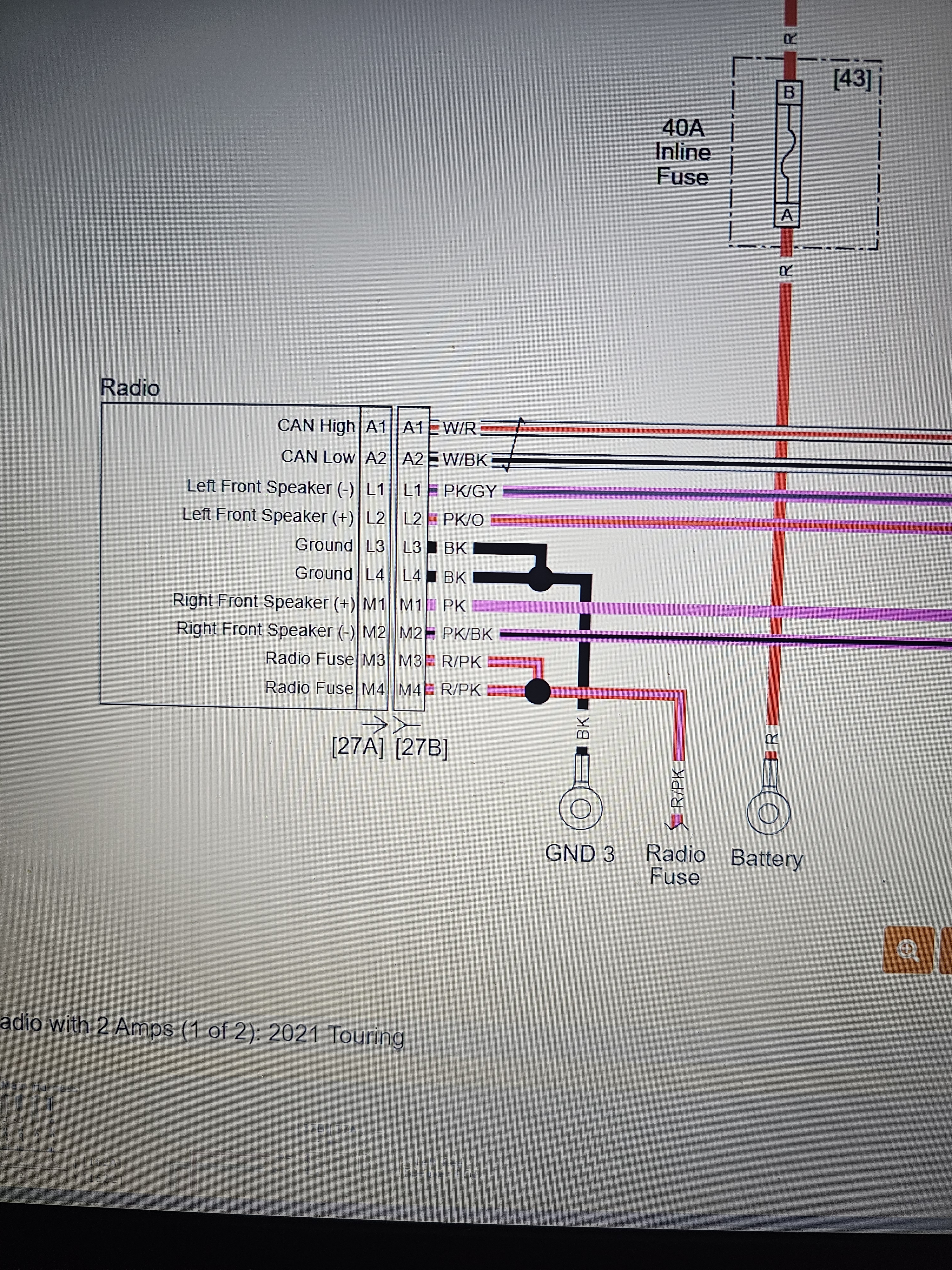

The CVO audio wiring only uses the front output from the infotainment system to supply audio to the system. The fader is controlled by the canbus system when more than 1 amp is present in the factory boom system.
I ran into the same issue a couple of years ago on a CVO upgrade.
You can check for yourself at the output plug of the infotainment system by pinning out the stock wiring plug.
You will need to run new heavier guage speaker wires to the saddlebags which is recommended when upgrading the amp

Thanks Rob. I wondered if that was the case. Only CVO i have delt with is a tri glide and it only had one amp.
