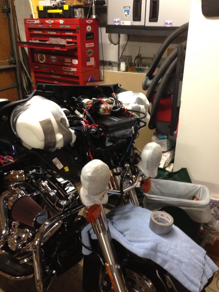

Just finished up my SS 4.520D amp and Biketronics 6.5 speaker install in my 2012 SG. I used Polyfil but suspect I got the wrong Polyfil. The stuff I got is like a foam pad not the soft fluffy stuff. Haven't tried to re-install my batwing yet, but suspect its gonna be tough!
Any thoughts on where the amp, Loc80 pr wiring is before I reassemble?
Thanks!

Wrong stuff. I used poly fill that I got from UltranutZ and had trouble closing fairing back up. Hopefully he can point me in right direction tomorrow.

Looks like your amp will hit the fairing B4 the PolyFil will. I put the Baffles over my speakers and had no trouble. Can you move the amp back where it is flush with the HU??
