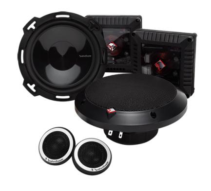

is this what they look like?

Old Jun 10, 2014 | 10:19 AM
AlBaron's Avatar
AlBaron
Joined: Jan 2014
Posts: 162
From: Chicago
Yes, thats pretty much it!

Well... Most manufactures offer comonent sets that would most likley be direct replacements providing they are 4 ohm...
Kicker CSS65, CSS67
RF T165-S, T1675-S
The fosgates are about double the MSRP...
