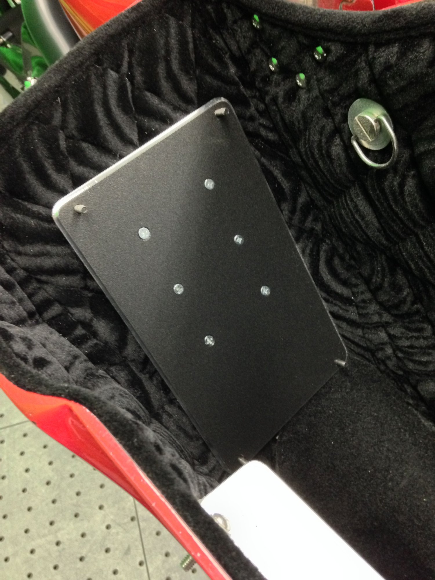

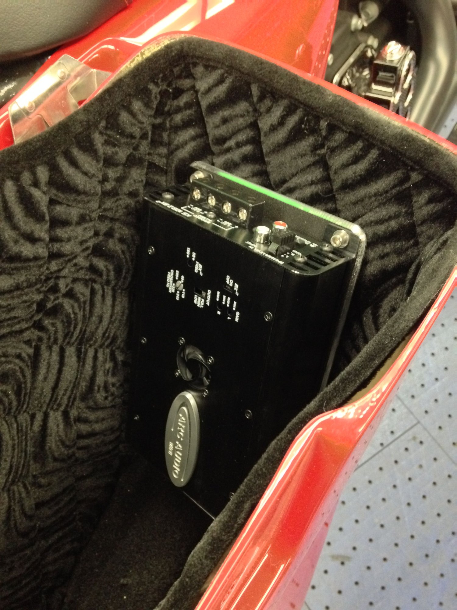

AmericanHardBag.com Amplifiers mount to inside of bag without drilling any holes
I make aluminum amp racks that are bonded not screwed to the inside of bags.
A 1/2" plastic plate is bonded to the bag below the aluminum amp mount. So the whole thing is removable/serviceable.

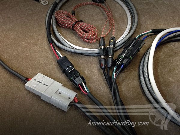

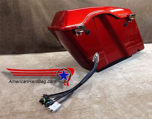

I also make quick disconnect harnesses for amps in bags.
