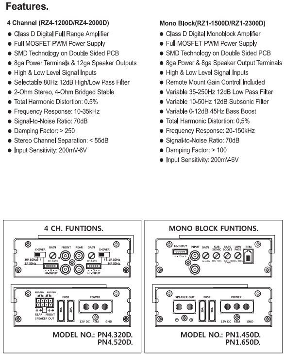

Originally Posted by AAWAV
Do not want to throw a wrench in, but if you consider the SoundStream, look at the PA RZ4.2000D. Gann, me and others have "determined" is is "louder/clearer". I actually took the 4.520 out and put the RZ in.
110 bucks...
I got this from the manual of the SS PN4.520D, between the brackets (RZ4-2000D) is mentioned. Now which on is which???
The manual can be found here:
http://www.soundstream.com/html/manu...ano-Manual.pdf

I was ready to pull the trigger on the SS PN4.520D but now another animal is on my way, RZ4-2000D. Spec wise are identical but the performance and SQ of RZ4 is better for some people.
Guys, this is a one time purchase because the amp will be shipped from USA to my country, so the right choice is very critical.
