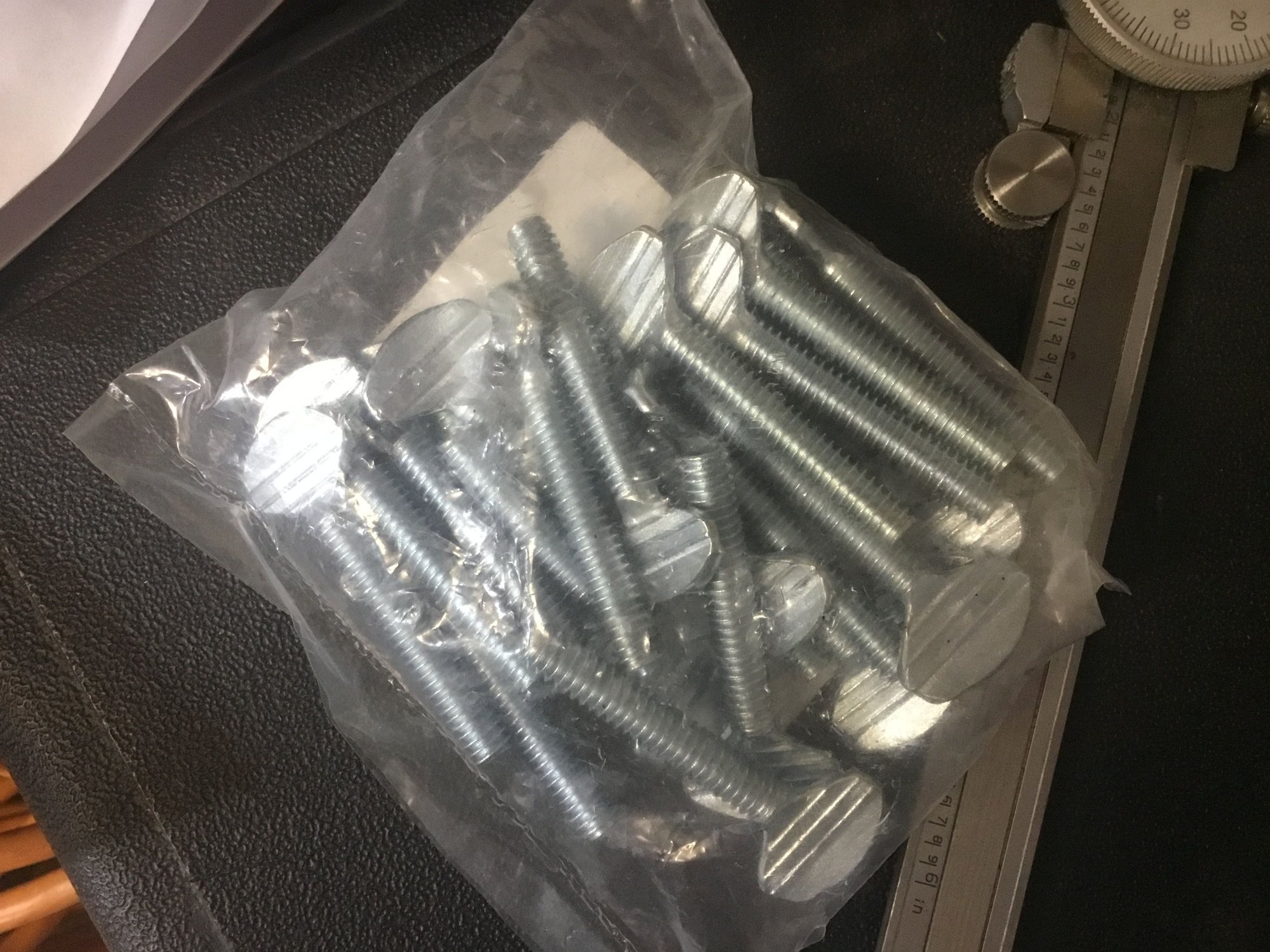

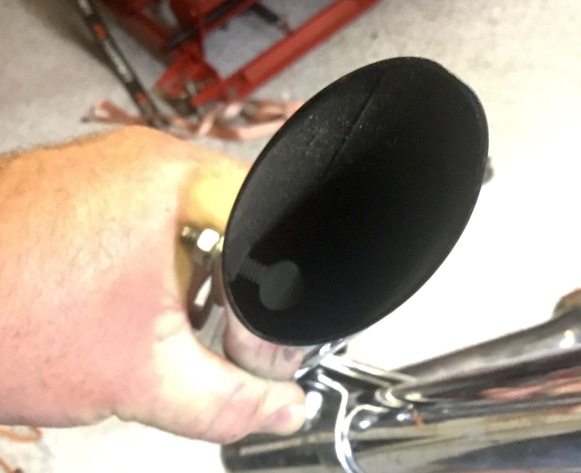

If money is tight.. this isn’t a big deal. Just go to a hardware store and buy large thumb screws. Double nut it at a depth that centers the Thumb screw in the pipe.. about 1.5 to 2” (from the end). Install the thumb screw, start at maybe a 45 degree angle.. then put red lock tight on the stud that sticks out of the pipe and tighten one more nut.
These are not double nutted on the inside.. I suggest that to make it easier for you, but with lock tight it’s not needed.
