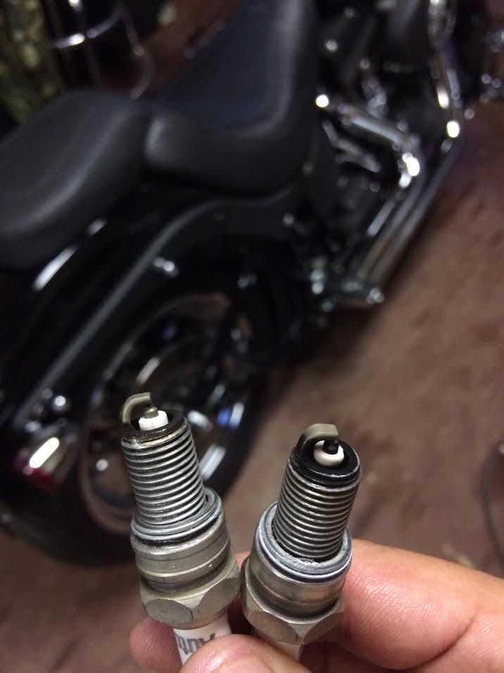

Replaced spark plugs with brand new plugs, here are the old ones I pulled out. Left one is my front cylinder, Right is my back.

As another member stated, take out #48, replace with #46, you should feel an improvement, may even drop further with a #45. Your plugs look rich.
