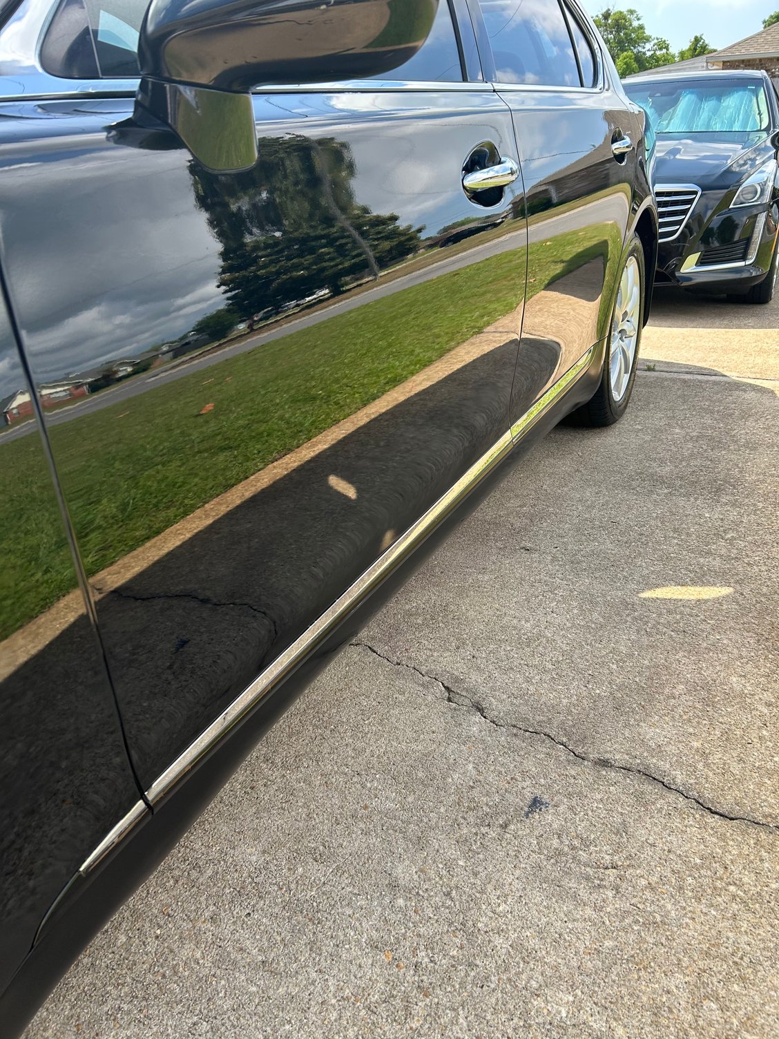

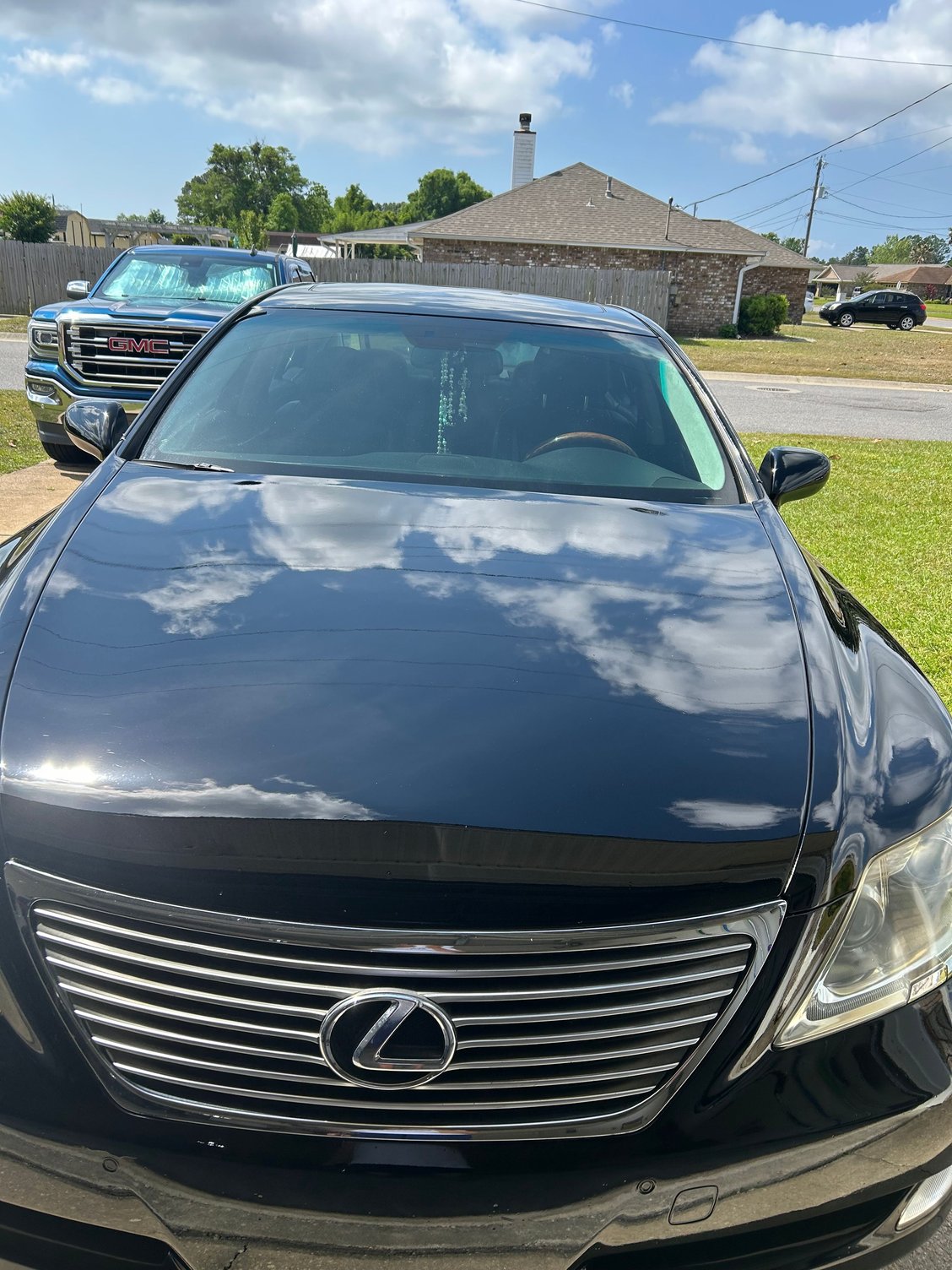

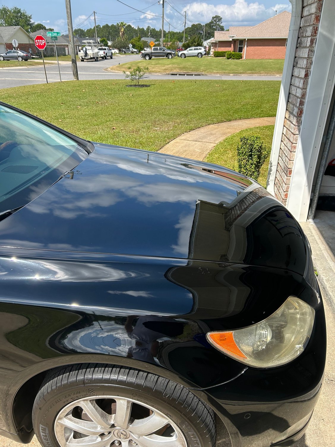

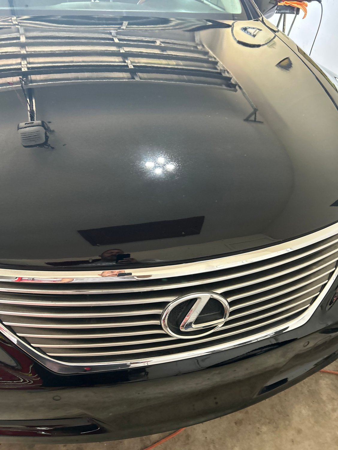

The customer that was scheduled this weekend fell thru. So next in line is this Lexus. This is/was the biggest car they made in 2008. Car has 213,000 miles on it. During delivery I was told that parts of the car were repainted. Which after going around the car with the polisher I suspected
Paint was absolutely hammered with are well water here, sprinklers. Owner wanted them out and I was thinking 1 time around should do it, I was wrong. Wool pad with Papa Cut and then polished out is what it took

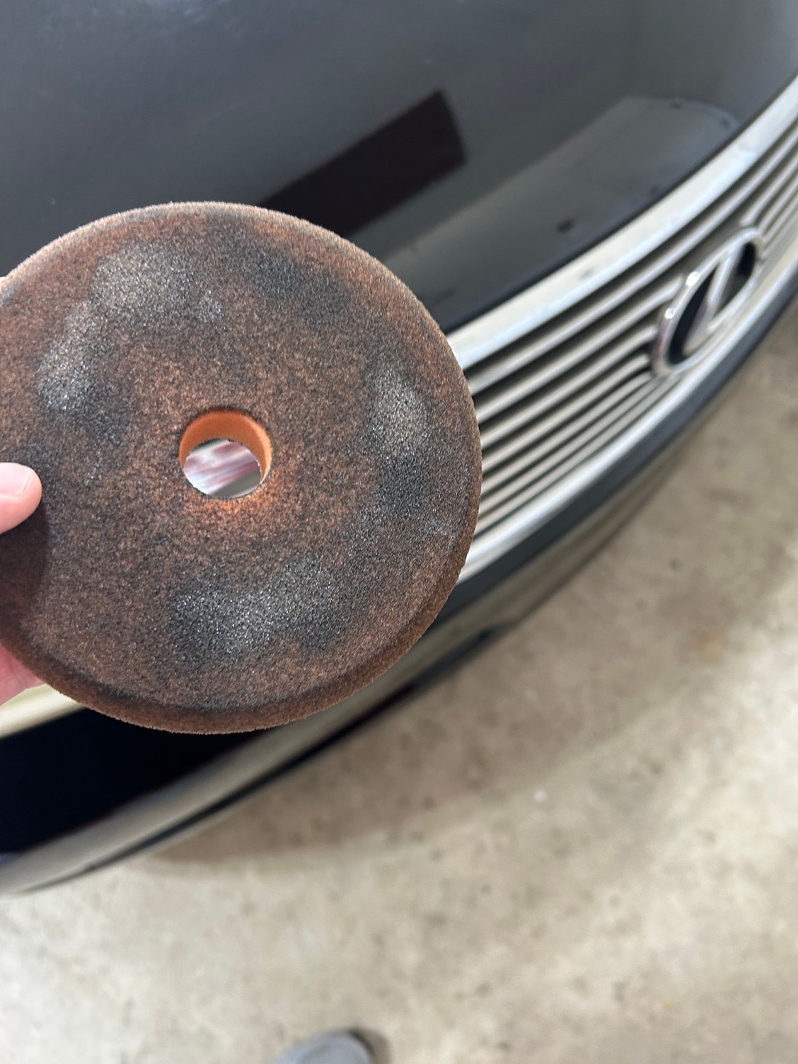

I still do t know if this was repaint in single stage or not. All the pads turned very dark. Could have been how imbedded the paint was with dirt, minerals from the water.
Car
50/50
50/50
Every pad ended looking like this
was washed with high ph, low ph. Clayed, Iron X. Compounded and then polished. Coated with DIY 3 year coating. Owner was thrilled and so was I. Not even close to the Vette from last week, but a major turn around. It’s definitely a 10 footer

Originally Posted by eaglefan1
Is that a before or after picture?
In serious need of sanding to get that flat. IMO.
Before. Not sanding paint that old. Car sits outside 24/7
