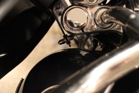

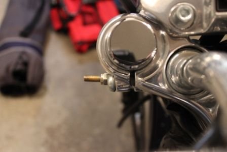

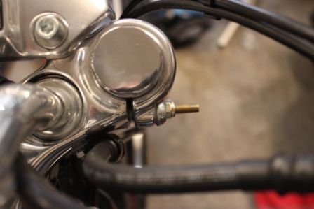

1st was to install the T-bolt clamps to the forks between the upper and lower triple clamps as shown in these pictures. These are supposed to be mounted with the bolt parallel to the front axle. But...
I had to rotate the clamps toward the front a little so the mounting brackets wouldn't hit my tank. I even tried and loosened up my tank mounting bolts to try to move back the tank back a little.
This side wasn't as near to the tank when I test fit the mounting brackets.

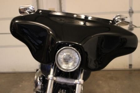

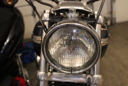

This is the headlight relocation mount to bring the headlight out and just in front of the fairing. Otherwise it has the "tunnel" look as some other batwing fairing have

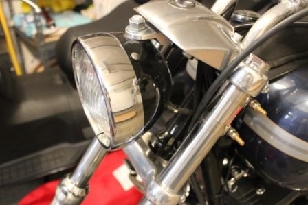

Here is a shot with the T-bolt clamps in place and the headlight in it's new position.

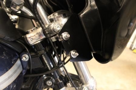

Here is a side view showing the T-bolt clamps installed. Not shown is how the fairing mounts to the T-bolts. They use a thick large washer, then a thick smaller washer, then another thick large washer and then an acorn nut. Sort of the same setup as other quick-disconnect windshields use.

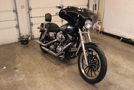

Finished, except for measuring for a windshield.
Another front shot.

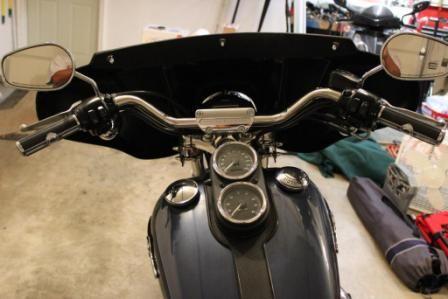

Here's what the back looks like.
This is where test fitting the fairing mounting brackets before you mount them to the fairing is critical. When I 1st installed the T-bolt clamps and test fit the mounting brackets, the bracket would touch my tank.
Here's a side shot of the fairing installed
The only part of the install that I didn't show was mounting the fairing brackets onto the fairing itself.
The fairing is able to be removed fairly quick with just 7/16" wrench.
