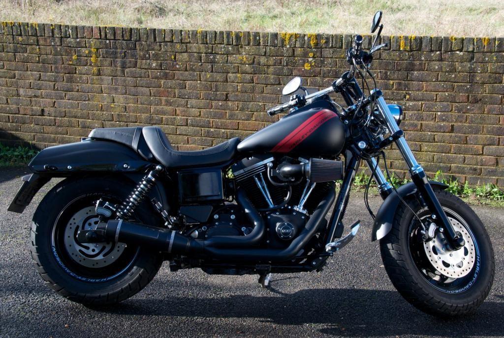

I'm very happy with them. We have some fairly rough roads here and the stock shocks would bottom out quite a lot and jar my lower back. Same roads with the Hagons - and no bottoming out.
The only problem is that now I can feel how bad the stock front end is and want to change that next....
I don't notice any more gap between the rear fender and the tire - see below. The fender is about 20mm higher so there obviously is more of a gap, but I don't really notice it. The 2014 FXDF fender is cut quite differently to pretty much every other Harley anyway, so it's a kind of love it or hate it thing....
