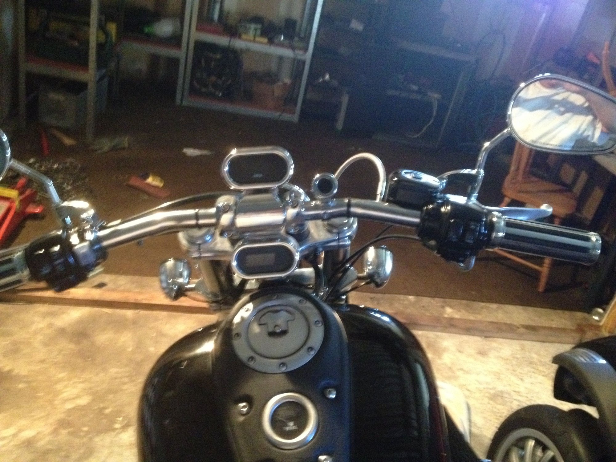

heres my Dakota set tach ,speedo ,gear indacator
that's horrible.
and goodgawdamittee - pick up the trash on the floor before you post pix next time.
thanks
