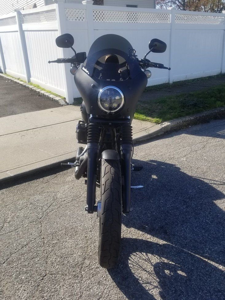

I scuffed up my Memphis Shades Gauntlet then hit it with the John Deere Blitz Black (the older original run of cans, the newer ones are too glossy). My front fender is aftermarket too so its painted with the same. Pretty much an exact match for denim. I've since picked up a can of the Harley Denim black but have not yet tried it...
