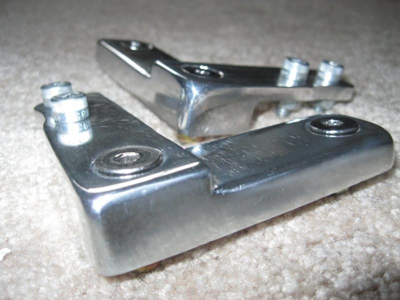

To add to what AFMM3 is saying about the differences between the lowers. The distance between the red arrows (in the pic below) on the Street Bob I believe is .75" and on the Fat Bob I believe is 1.5", this is where the bracket mounts to the fork. When you start mixing parts between models, you might need to make some mods. I had to machine out the area where the blue is in the pic obtaining the shape seen with the blick line.

Here is a pic of how I had to mod my bracket.

So was the fender plus the brackets too wide to go between the fork lugs?
