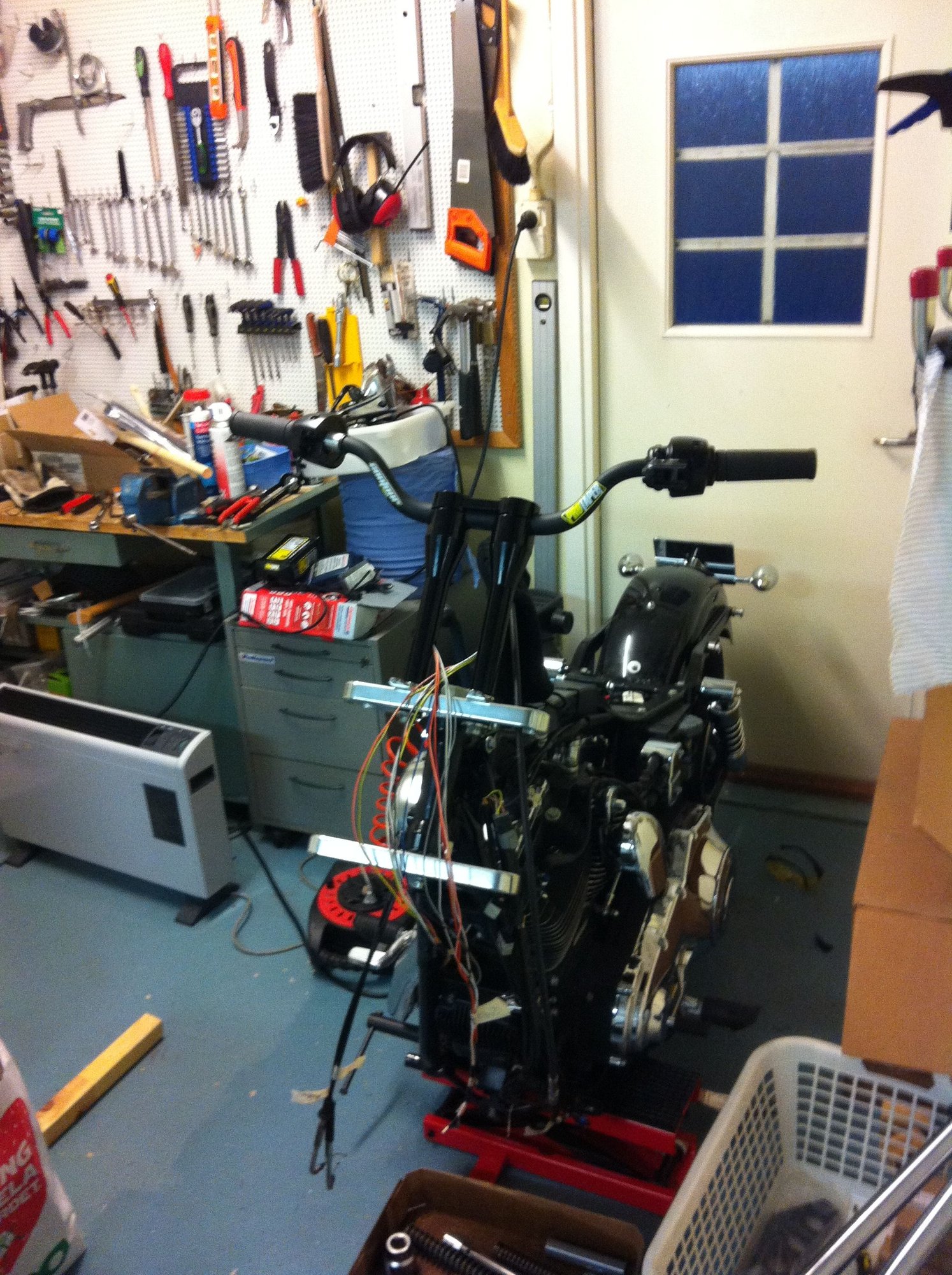

Btw, just installed some new forbidden bars and riser, will put on a quarter fairing too
