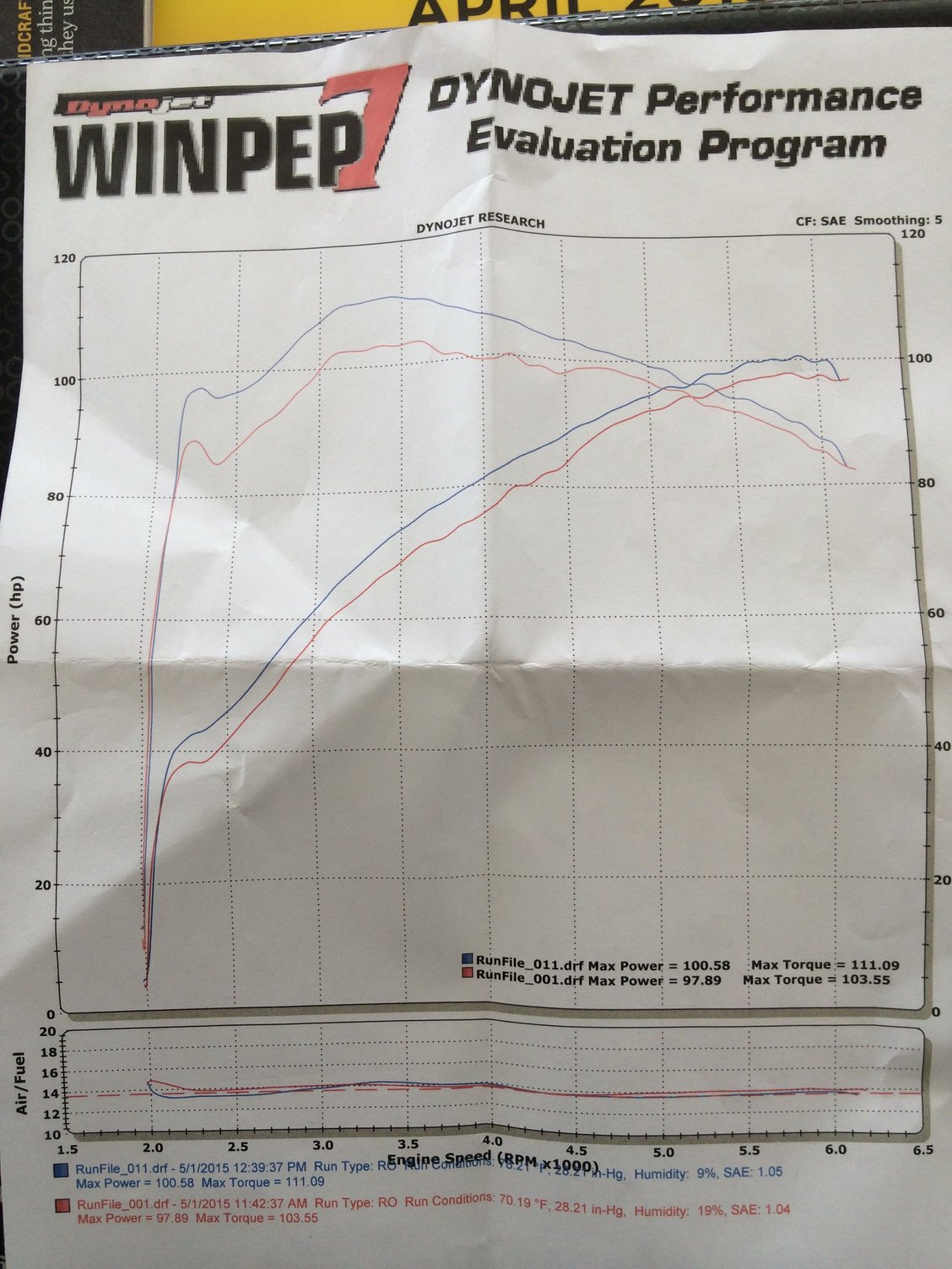

What does the dyno sheet look like I would be curious to see, sounds nice.

Superglide2012's Avatar
Superglide2012
Joined: Mar 2013
Posts: 22
From: ND
