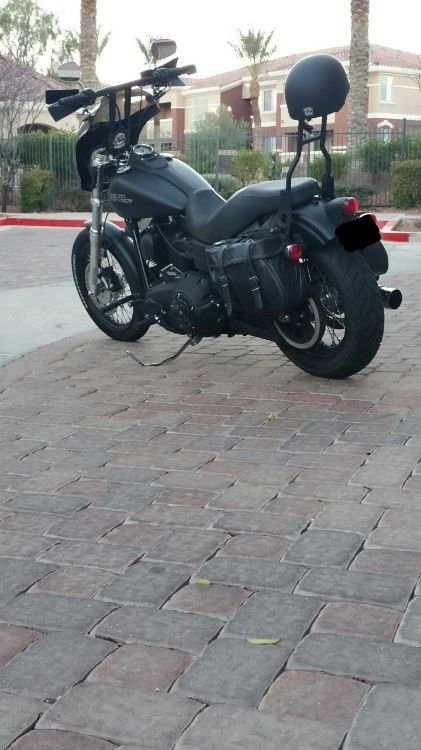

2011 FXDB with quick detatch. Bought the turn signal relo, and the docking kit from ebay seller beosaid for $35 and $34. Becareful with the bolt struts though, they are really easy to snap if you apply any pressure that isnt straight on. So any downward, or upward when you are screwing them in, and snap. Should take you about an hour to do all the wiring. Quick tip, when unbolting your fender, do the front bolts first, before trying to do the back. It makes it a helluva lot easier.

Looks good. I like the plate below the taillight a lot better. I'm thinking about doing something like that plate mount with mine. I do have a different taillight, but I don't think it will be difficult to do.

Stock on the 2011 fxdb.
