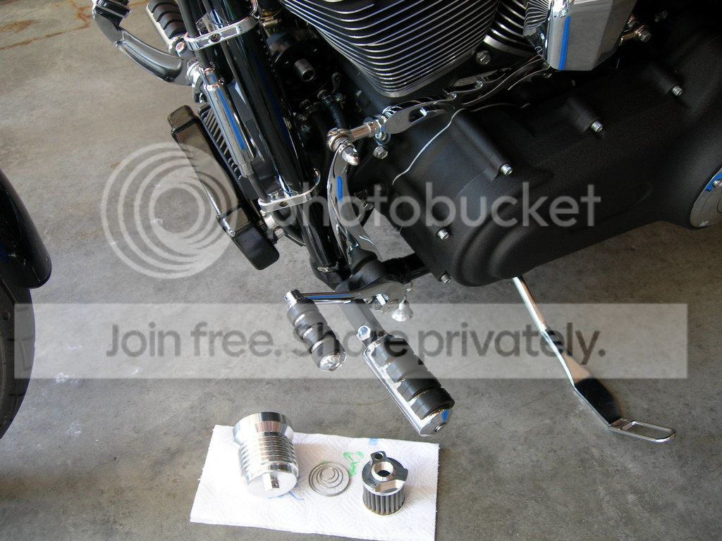

Easy to clean I remove the oil filter housing with a 17mm socket, remove the cartridge and spring from the housing and spray the stainless steel filter media with brake cleaner from the inside out, push the pressure bypass on the bottom of the cartridge a couple of times to let the brake cleaner drip through, wipe down the filter cartridge and rare earth magnet with a paper towel and then allow it to dry for a few minutes; use paper towels to wipe down the interior and exterior of the billet housing and the spring, put the spring in the housing with the small tapered end facing up, put the cartridge back in the housing, push down and rotate it to lock it in then put a bit of oil on the quad ring and reinstall back on the bike, seat the filter then a 1/8th turn with a 17mm socket.

I can normally get 5 - 7 removal/installs before the quad ring starts to look a bit distorted and I change it out. I've got a box full of Z-065 and Z-064 quad rings for the PCS1's and PCS4 filters, I've used these permanent filters for ages on my track bikes and HD's. You can get additional Z-065 quad rings from DK Custom for $1.50 each: http://www.dkcustomproducts.com/Repl...K-OCOF-RNG.htm
If the face of your filter housing is smooth and you're not heavy handed seating the filter you should see a few more changes before you notice the quad ring beginning to distort. A friend of mine started using the PCS1 on his new Gold Wing and destroyed the quad ring every change, I found a sharp burr on the filter housing on his Wing, once I got the face polished he was going though 1 quad ring a season doing 6 -7 changes; he rides a lot
I come at HD's from an old school perspective and run SAE 50 Valvoline VR1 racing oil. Fuel injection aside, these are still older tech air cooled pushrod engines, the VR1 has a higher zinc/phosphorus content than more 'modern' oils, my older HD's and now my '13 seem to like it
