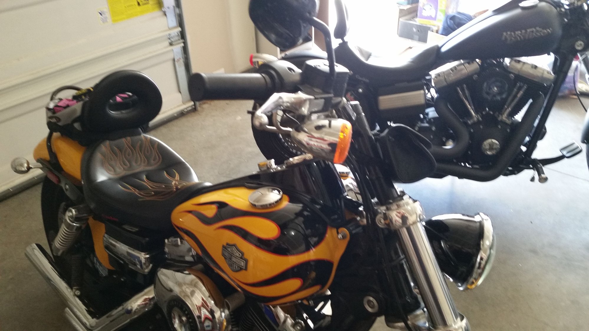

I ordered the extensions on Monday (30th) and received them today (2nd). Holy crap that was fast! Thank you DK Customs for not only shipping stuff out super quick, but for making awesome products!!
It's not letting me post up pics right now. I'll see if it works later.
Pretty straight forward install like Tin said. Remove riser bolts (3/4 socket), pull some slack in the wires, place riser extensions, and install new bolts (included in kit, & correct size), tighten then go. Like said it would be a little easier with an extra hand, but it was doable with 1 person.
