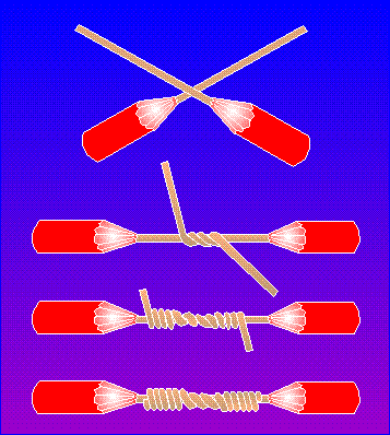

Do what's called the western union method:
It creates a mechanical bond first then you add the solder to further strengthen. Solder alone isn't that strong. Get the iron nice and hot, tin it (apply solder direct to tip of iron, coating it evenly), then touch it to the joint you made as above and touch solder to the joint. It should flow into the joint. Slide heat shrink over, hit it with a heat source (lighter, heat gun), and you're good to go.

Genius, I will be using this
