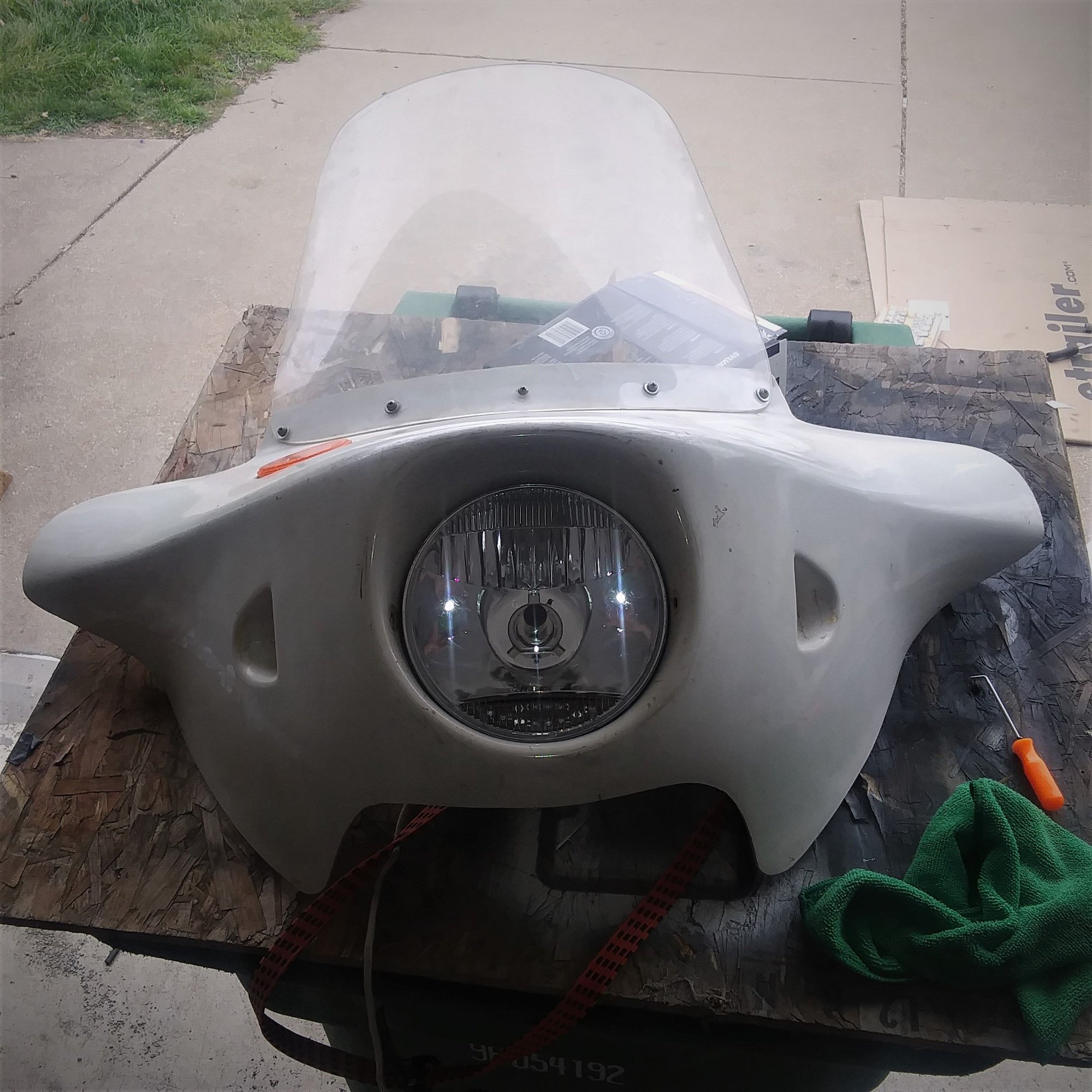

I bought this fairing back when I had my first Dyna. No clue what brand it is, There are no markings in it and its fiberglass. Hoping someone here has seen this before and has some info. I plan to install it on my Fat Bob.

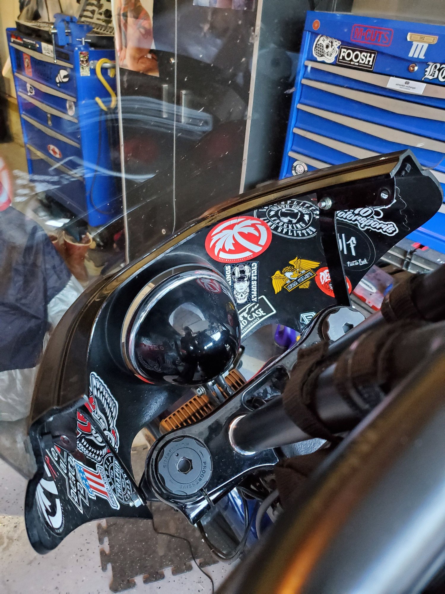

Rifle Roadster fairing on a street bob, the brackets they supply are terrible, made my own using 3/4" flat bar just bent and painted. Used some amazon 49mm turn signal clamps to mount Rifle uses the pinch bolt clamps to secure and not a fan of that. Got the fairing off kijiji and ordered a 18" shield from rifle, which took about 10 weeks to get. Really not the best to deal with. But looks good. Used all last summer and not a ton of buffeting, hoping it's less now with the new orientation it's set at. Pic of old bracket included
3/4" flat bar just bent to fit

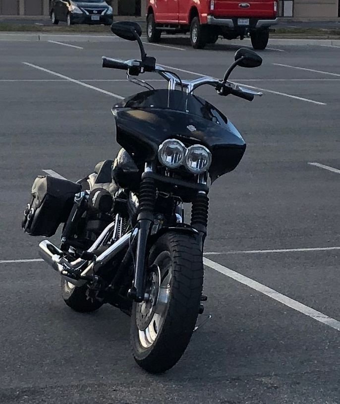

Arlen Ness Bob Dron modified for my Fat Bob
