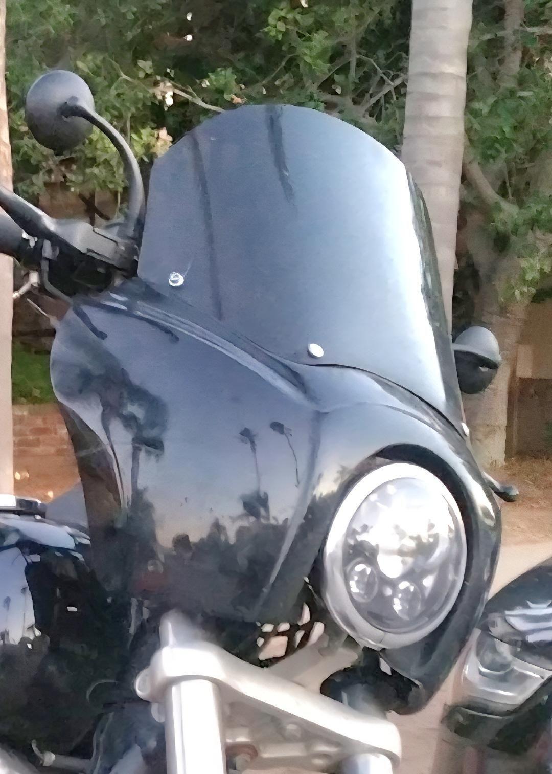

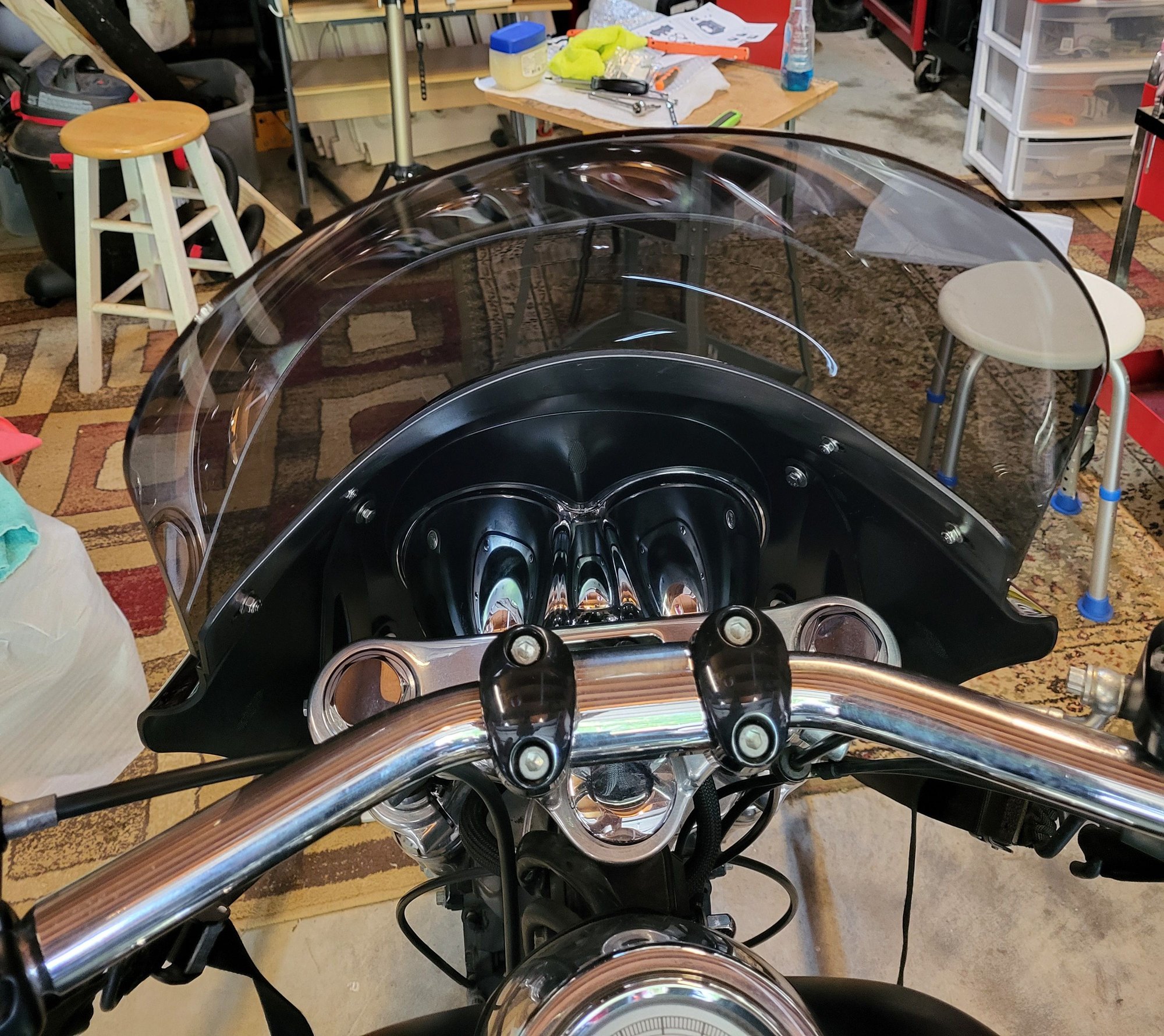

Default Amazon Special

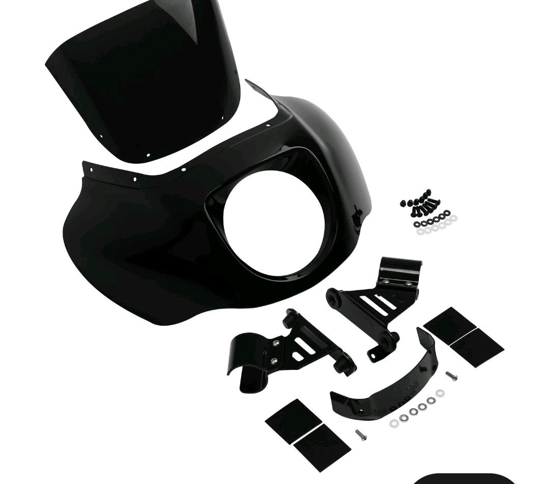

Got this off Amazon Form, fit and function are great. It is not a quick detach, that's the only negative, but it works great.

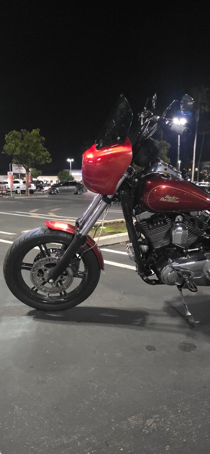

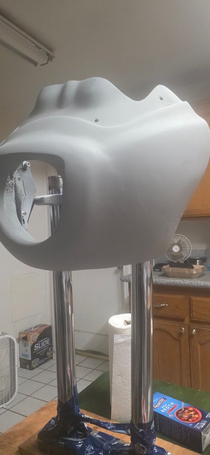

Default One of one detachable fairing

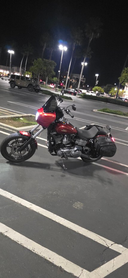

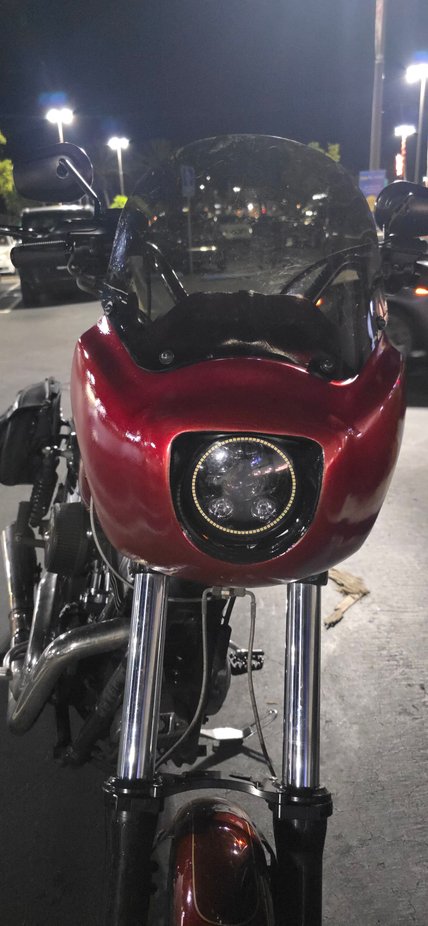

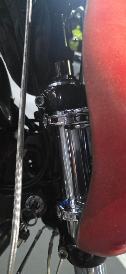

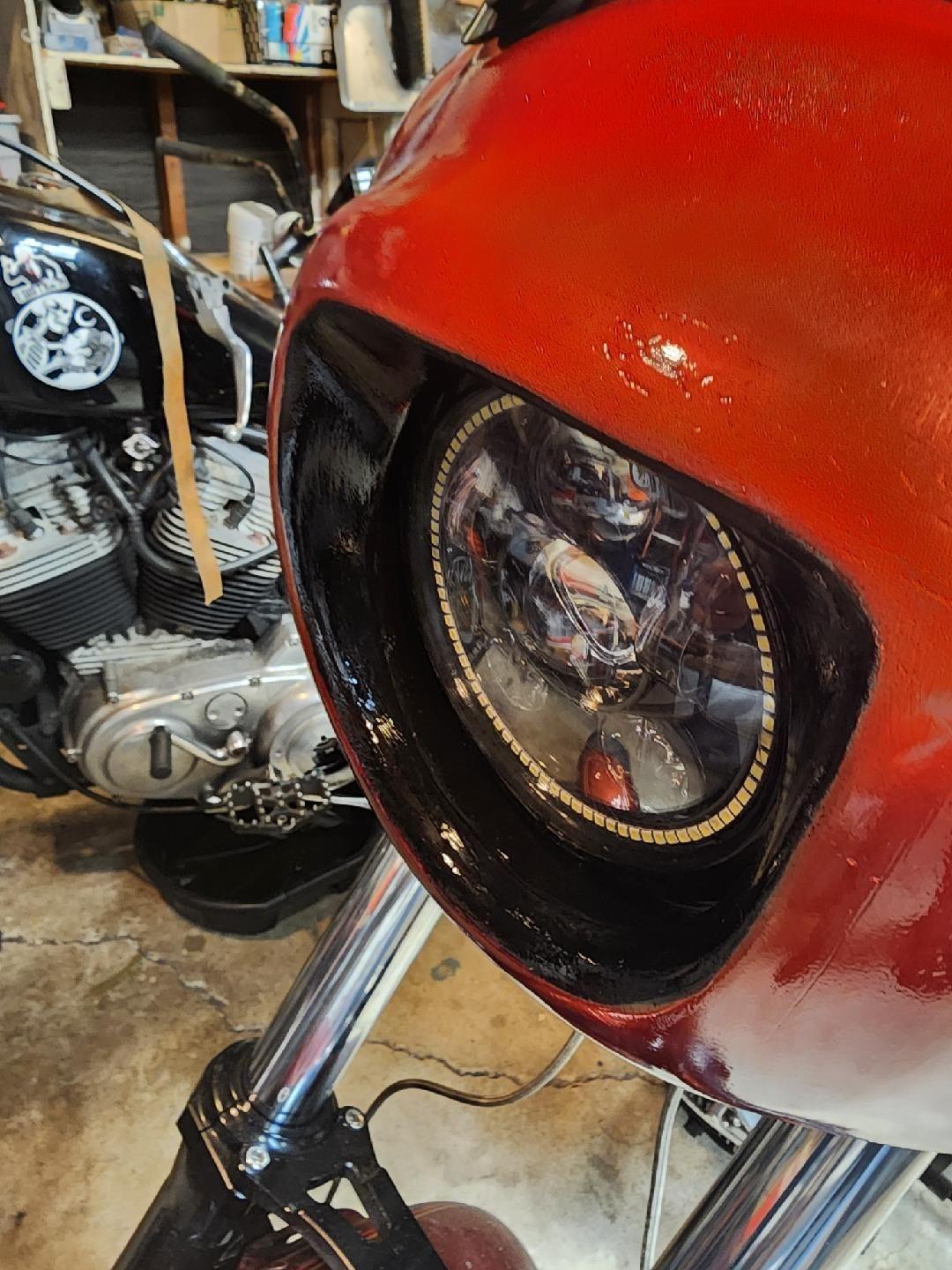

I made another fairing using an old conley usa t-sport fairing and part of a new softail fairing with harley-davidson quick detachable clamps off an old clamshell/quarter fairing, and fiberglass. I made brackets out of some joice hangers and aluminum and it goes on my homemade top triple that I had mounts welded on and use a top mount headlight. I made the headlight extension out of some simpson hardware I had laying around.
