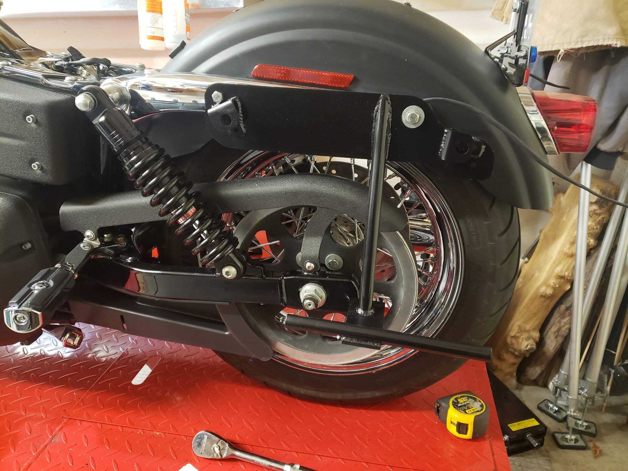

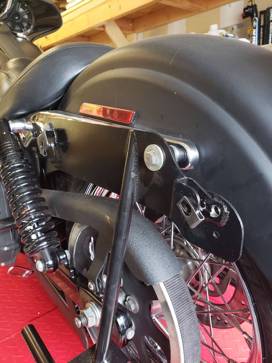

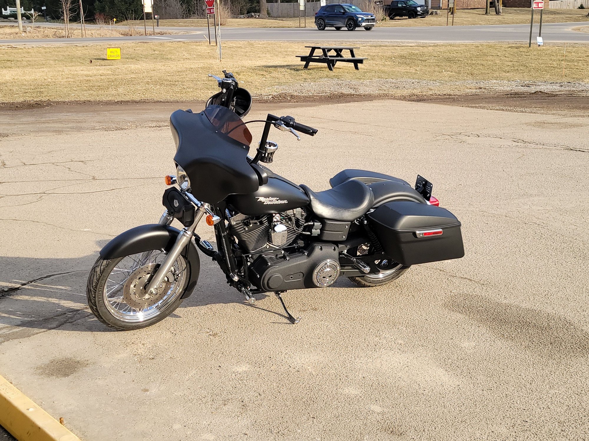

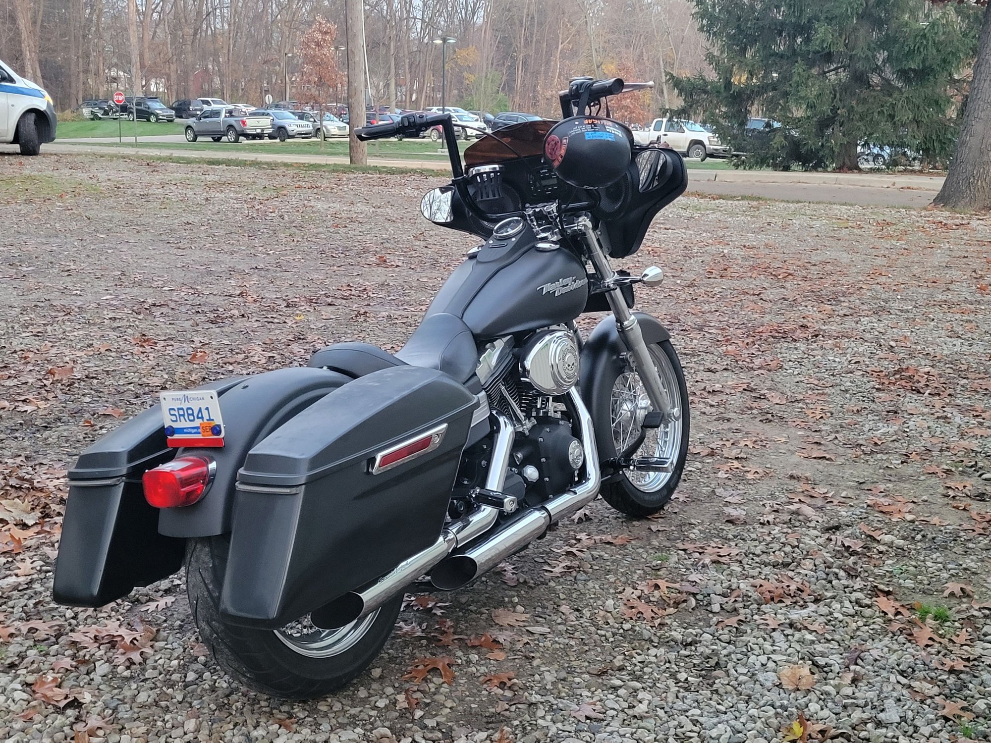

Default 06 street bob
06, usa trailer store fairing, 400 watt kicker amp, ground zero 6 1/2' coax, electra glide fairing mount mirrors, Klockwerks front fender, custom bag mounts with Harley Davidson bags, lowered 2", 14" LA chopper bars, internally wired, light motor work, FUN bike

Sharp looking man! Really dig that front fender. Did you make the mounts for the bags?

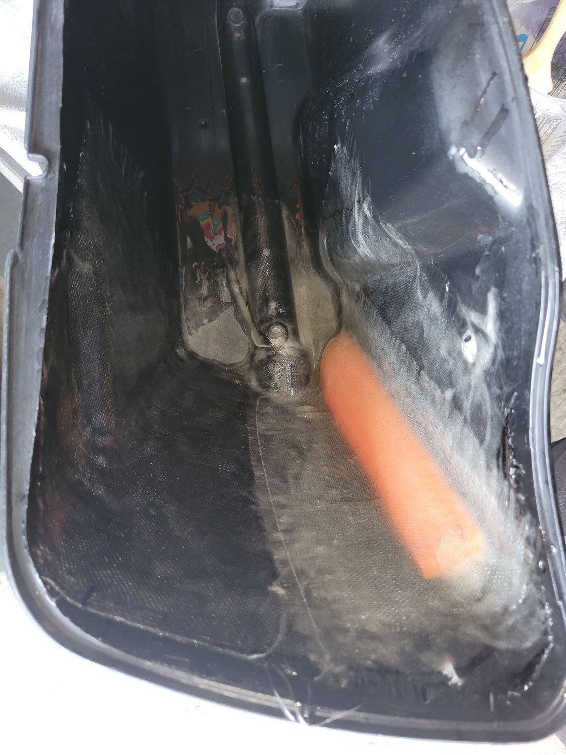

yessir, been ride with it for 2 years, holds up great, ive packed them down for solo trips with way too much weight. pocketed the bags to accept the shocks, cut out and used a pool noodle to make the form, used epoxy resin to fiberglass the inside of the bag

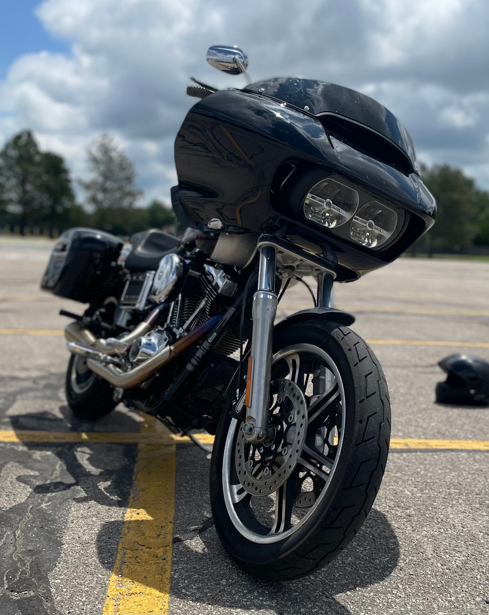

Default Road glide fairing
Here is the fairing and bags I put on my bike. Thought I’d see what everyone thinks. I will be getting it paint to match the tank, add the stero and gauges this winter.

Whoa! I've never seen a shark nose on a dyna! That's sick! 🔥

looks awsome, love seeing dyna baggers

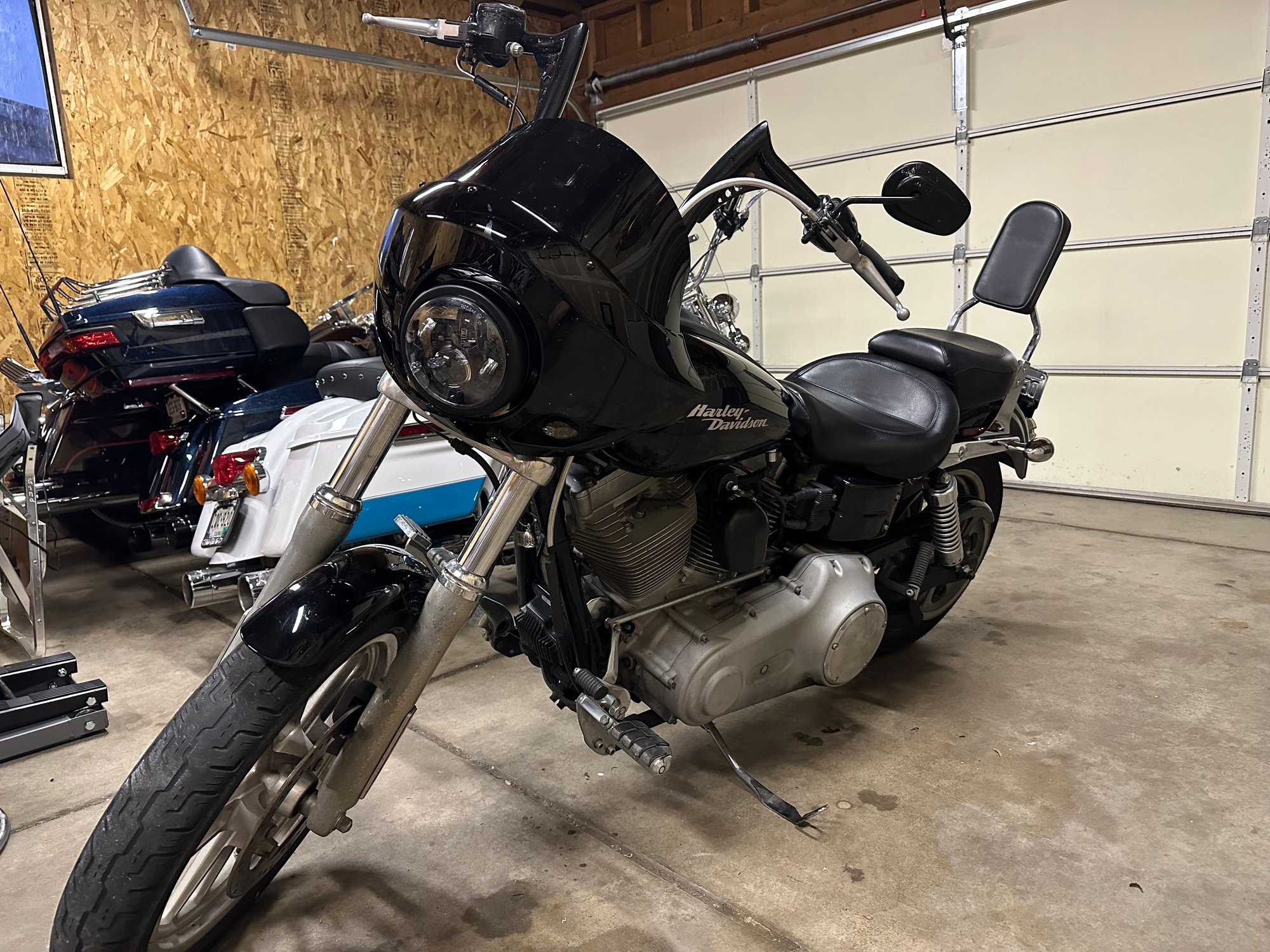

Cheap minimalist fairing from Amazon. I put some small but bright LED turn signals in the fairing and rather than leave the headlight mounted to the lower triple tree behind the fairing I mounted the headlight to the fairing as well. The bike is going to be kind of a winter project. The sissy bar is getting ditched and I’ll probably find a solo seat for it. Probably going to black out as much as possible and maybe bob the rear fender.
