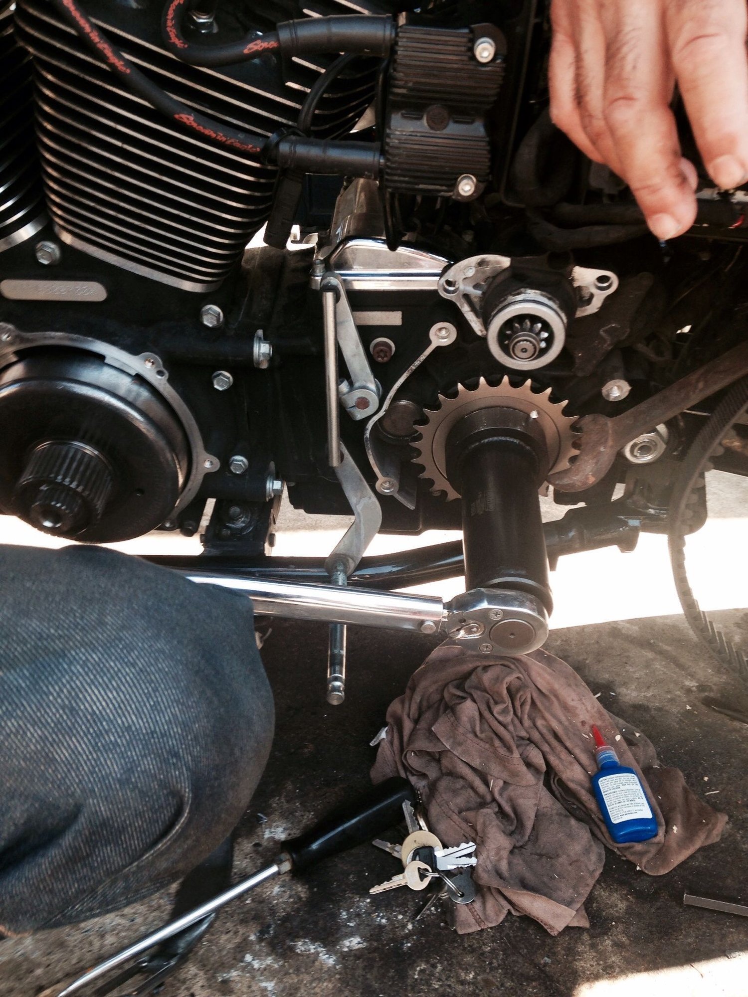

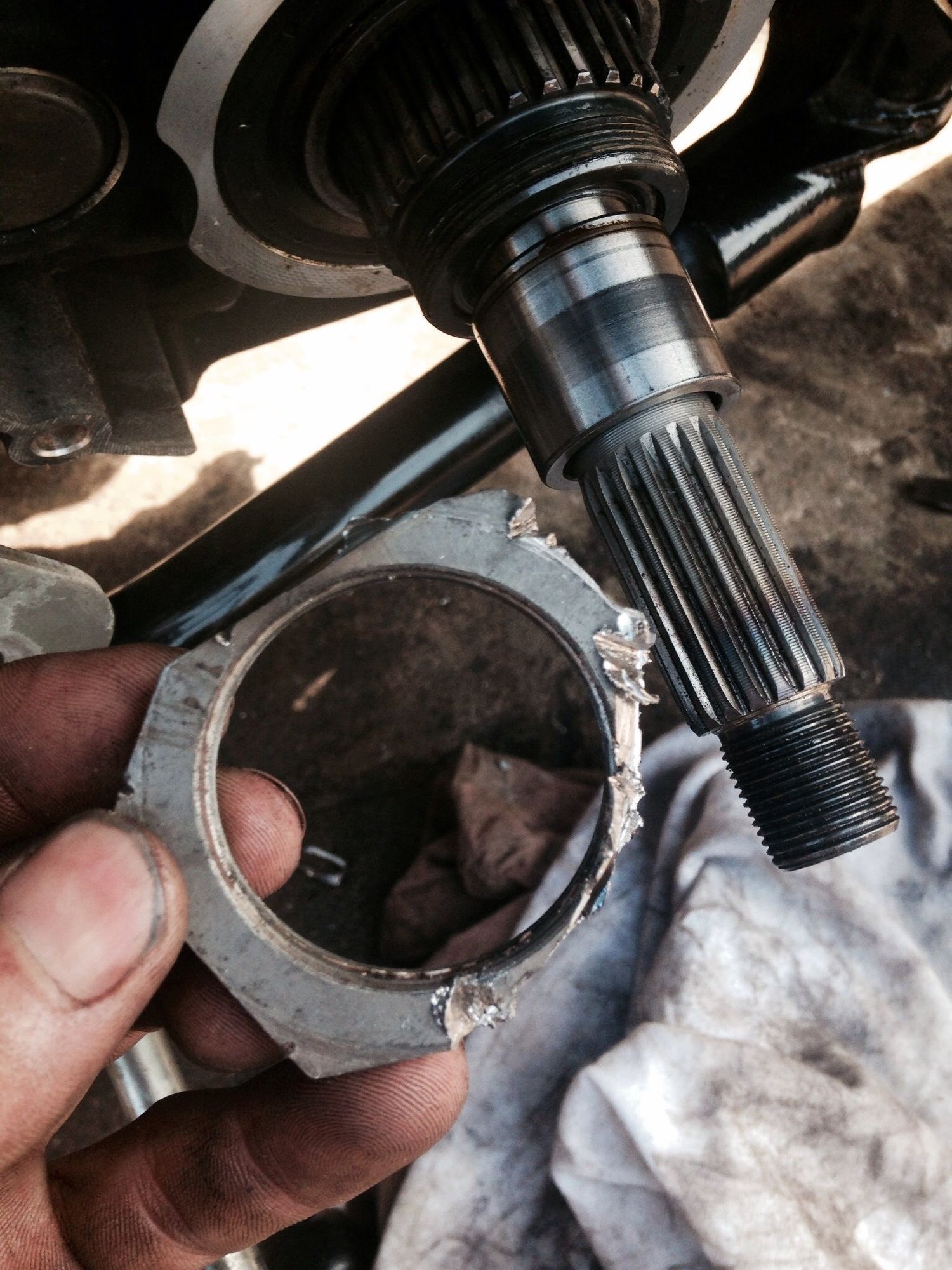

The trans nut was a pain the ***, didn't mess up any threads though. Cut it down, then chisel off, I am doing another chain drive on Tuesday. On a friends bike.
Bung king slider, .500 24t .875 spacer on rear 55 t flat spricket
It's work, to do this be prepared.

I work on a bunch of HD's at any given time. To remove the front pulley / sprocket nut I agree it can be a pain and it can give you fits especially on a Monday morning with only 1 cup of coffee.
That being said the method I use generally... and it seems to always work;
1) Leave the final drive of the bike hooked up, rear axle on...belt tensioned.....rear wheel intact.
2) Primary off everything off there. Use your CORRECT mainshaft nut socket (Heartland) on the big nut with a QUALITY (Snap On) 1/2" drive breaker bar attached.
3) Place bike into a corner of your garage, shop... wherever. Front wheel dead ended into a corner.
4) Slide a 4' long pipe over the breaker bar. A floor jack handle works good.
5) Have someone help you by sitting on the bike and pressing on the rear brake pedal...in a pinch...tyrap the rear brake lever down.
6) PUSH the pipe/breaker bar/socket combo DOWNWARDS towards the ground. Not "up" from the rear of the bike.
This will break the mainshaft nut loose no problem.
If the bike is torn down with no rear belt/chain/wheel......then you need to buy the pulley locking tool or wedge a block into the sprocket. Then do all the same with the long cheater pipe and socket/breaker bar.
My $.02
