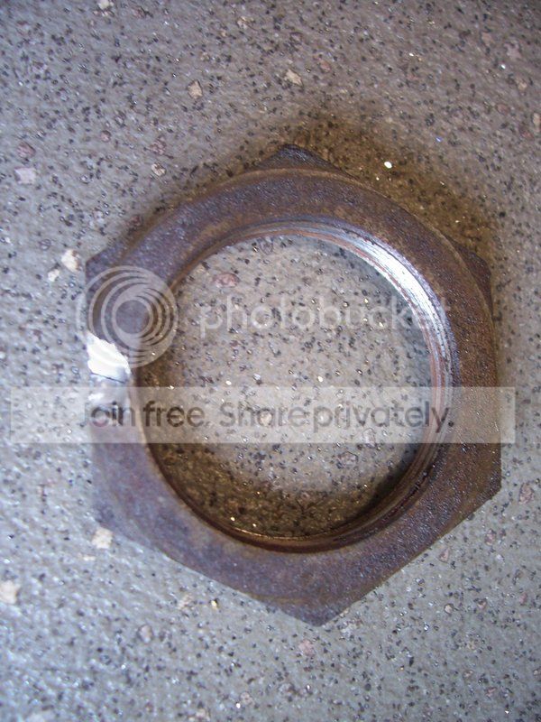

Well even with the new 750mm breaker and me putting my full weight on it and bouncing up and down the nut wouldn't shift,it was all going to end up messy probably with the bike toppling off the stand with me underneath it so I decided to grind it off with a Dremel.
In the end it wasn't too bad,just ground a groove 3/4 way through it and gave it a couple of whacks with a chisel and it cracked.

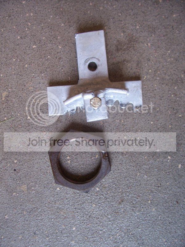

At least my homemade pulley tool worked held out well although it won't be much use for holding the sprocket.

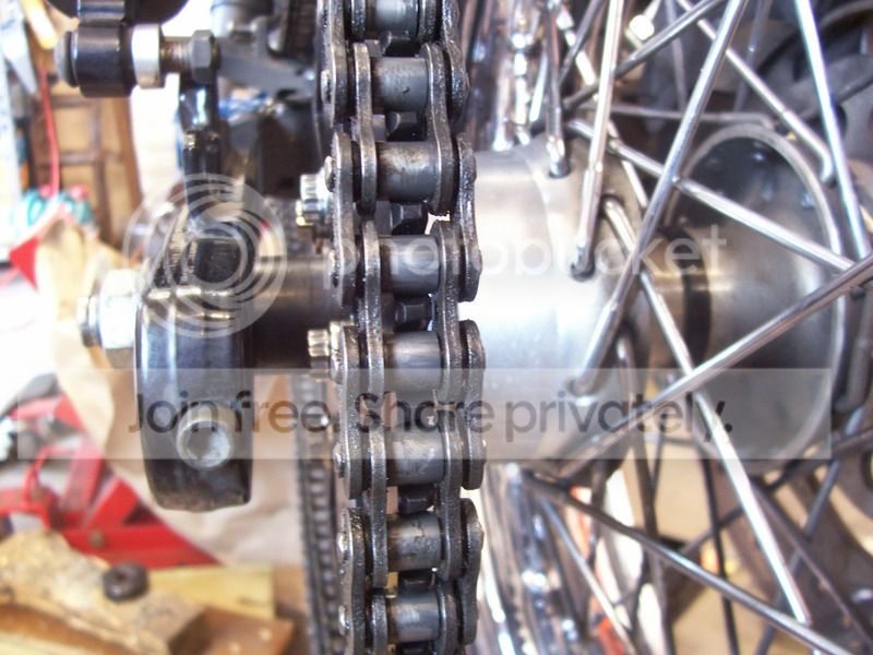

The only thing I am not too happy with is the Bung King rear sprocket which is very thin,I should have realised as it states on the website that it is suitable for 530 and 520 chains,there is a lot of sideways play on the chain and only time will tell if it will get chewed up quickly,I wish now I had gone for the PBI rear but I wanted to get everything from one vendor to save shipping.
