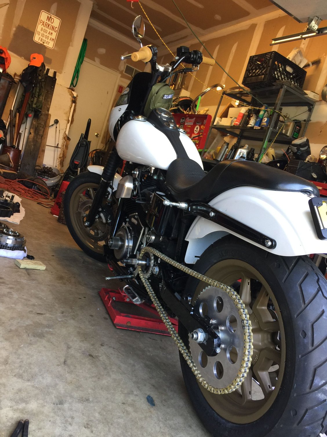

Finally did it , only complain I have Is chain vibration at highway speed 5th and 6th anyone else feel
it ?

Looking good 96.
That's a neat combined sprocket securing nut/locking plate you have fitted.
I have a few miles on mine now with no issues so far,can't say I have noticed any extra vibes at all,mine has a Predator motor mount fitted which does transmit a few more than the original mount anyway.
Gave it a good thrash yesterday for 40 miles holding 80-105 mph chasing a Honda Blackbird and really liked how the lower gearing has made 6th a more usable gear.
Time will tell how it holds up but so far so good.
