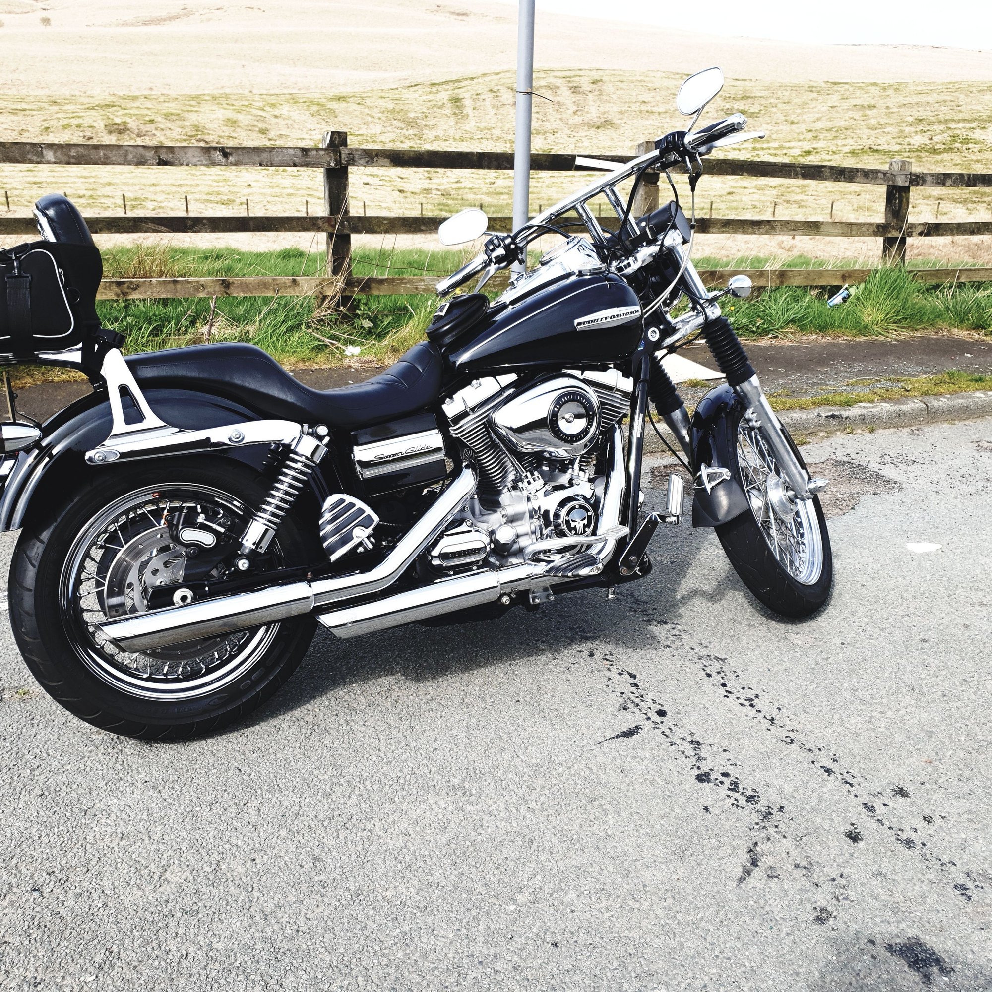

Yes a big problem cant get out on it enough in England cause of the bad weather.. But once out i love the bike
