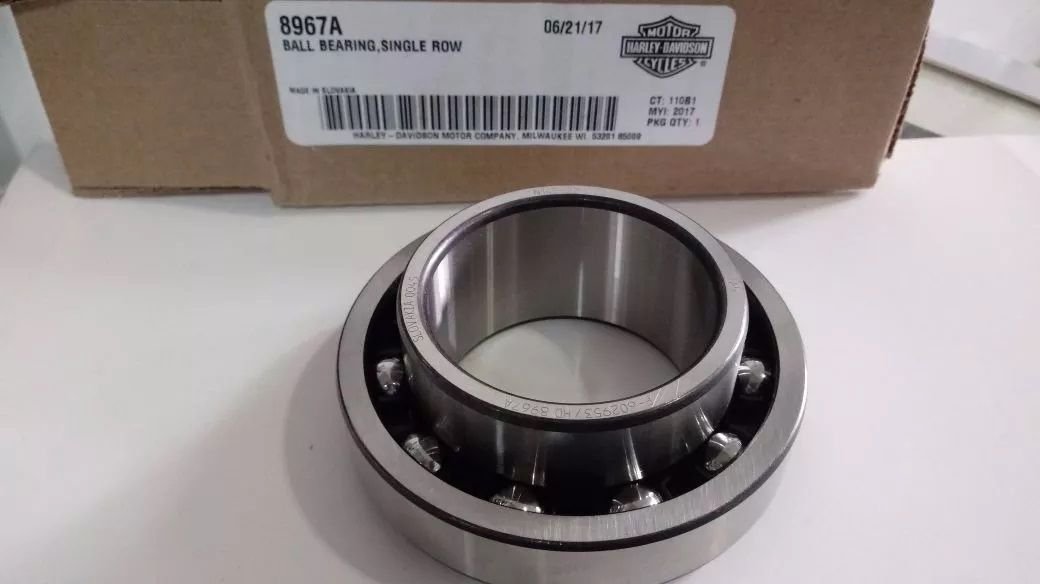

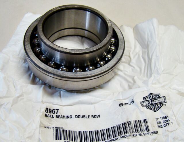

So...here you go. 2006 fxdbi with 75,000 miles. ( see photo of hydraulic tensioner.) True, inner primary bearing failure ( double row bearing )...caused wear and tear on drive shaft.Upgraded to the single bearing superseeded (A) version. True, front motor mount fails, and I did mount a Predator ( highly recommended ). $1000 in the hole for this repair...but worth it.
On a second note, that hasnt been mentioned about 2006 dyna's....the drive shaft has been revised 3 times...(C). I was told there was a hardening issue with the steel ...anyway, got the new drive shaft as well.
75,000 miles
Older double row bearing, fails.
Newer single row bearing.
Primary complaint was a high pitch "squeel" along with a "shiver" like vibration. That is, on and off type every few seconds.
