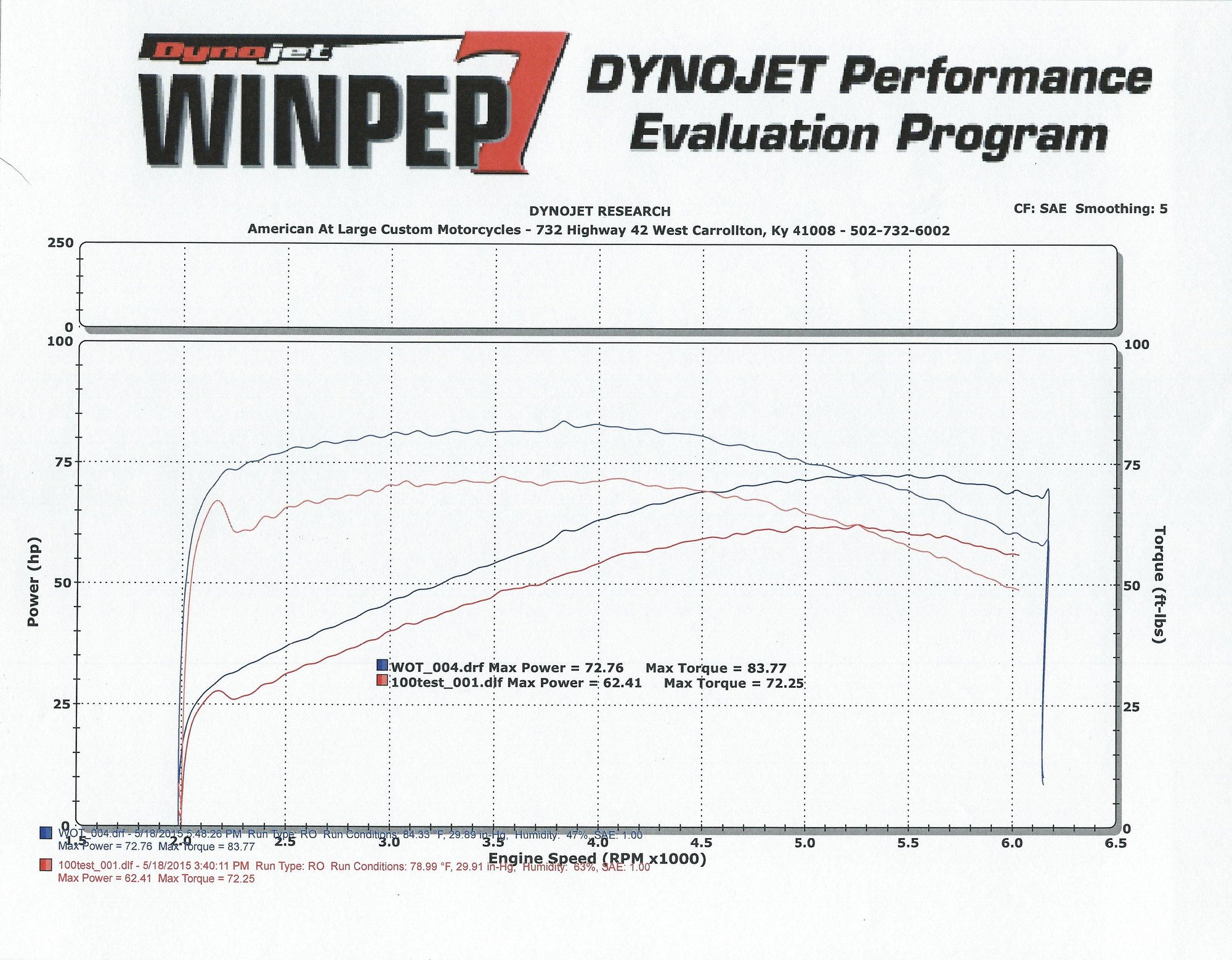

Originally Posted by Lockeshill
What's my best options and what exhaust/air filter combos seem to be worthwhile. I'm ready to go 2 into 1...new air filter and re map as needed. And...is the 2 into 1 worth it and all its cracked up to be?
This is what I got with just used eBay V&H Straight Shot slip-ons and a Big Sucker. The second curve is after a Power Vision dyno tune. This is on my '07 FXDL.
