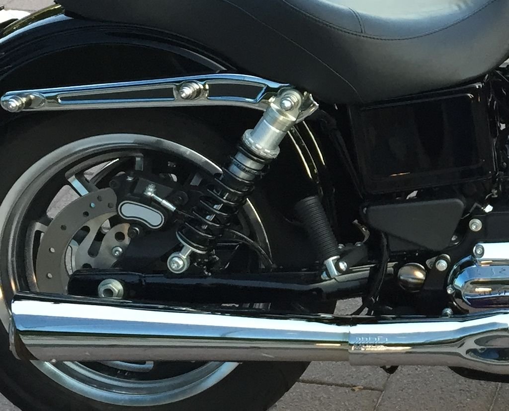

They were a little of both. Howard replaced them with longer and higher rate springs (with a one day turnaround!!!) and I am now at a normal amount of preload and travel. Seems every mile I put on them they get better! I'm only at 200 miles or so, so once I hit 500 I'll re-measure sag and travel, but I gotta tell you, they are awesome. As is Howard's service.

So I got my S36E's dialed in nicely, thanks to Howard at Motorcyclemetal.com, and now its really showing how lacking the forks are. Even with the set of Racetech springs and emulators (which are a huge improvement over stock, mind you) they still feel "loose" compared to the rears. It's funny, the racetech stuff went in first, and the forks felt better then the stock rears, then the Ohlins rears went on, and now the forks need more.
I'm now going to look at the 30mm Ohlins cartridges Howard sells. I'll probably send mine down to him for installation over the winter when I send the tins out for paint. I asked Howard for a ball park $# so I can prepare to pad my hidden bike mod budget...
Damn Ohlins, why are they so good?

What is the ball park $# on the cartridges?
Be nice to have some on my SB.
Also, do I spy a compression/ rebound adjustment screw at the top of the shock?
