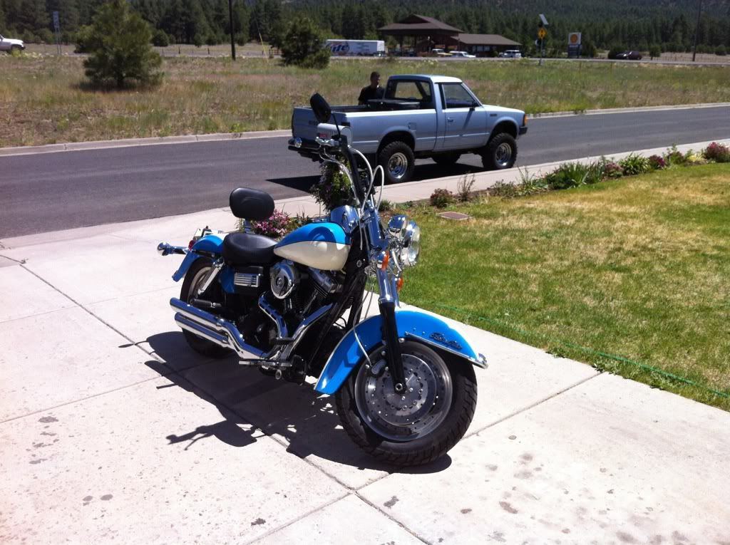

In my opinion your Fat Bob would look good with FL fenders. I have seen Fat Bobs with FL front and rear fenders. Klockwerks makes an adapter kit. Allows you to go switchback or FL softail front fender. I put Fat Bob trees on my Street Bob and adapted an FL fender. I bolted a Switchback rear fender right up to my bike but I think the Fat Bob rear struts would need to be spaced to get the switchback rear on there. Street glide or road glide rear fender would probably be a tighter fit on the rear. Below is a Fat Bob with FL fenders from the FL Dyna group.
Below is my street bob with Fat Bob trees and switchback fender on rear and a blank FL front fender I got on eBay for $99 (with softail deluxe trim added).

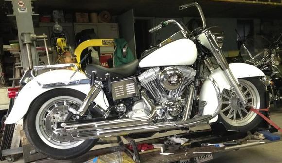

on a 2005 FXD, you would need to go with the 2008 and older FLH rear fender. FLD and 2009+ FLH rear fenders are too wide to get between the struts.
Here is my father's 2005 FXD during the build
Here it is after a few years and about 50k miles.
