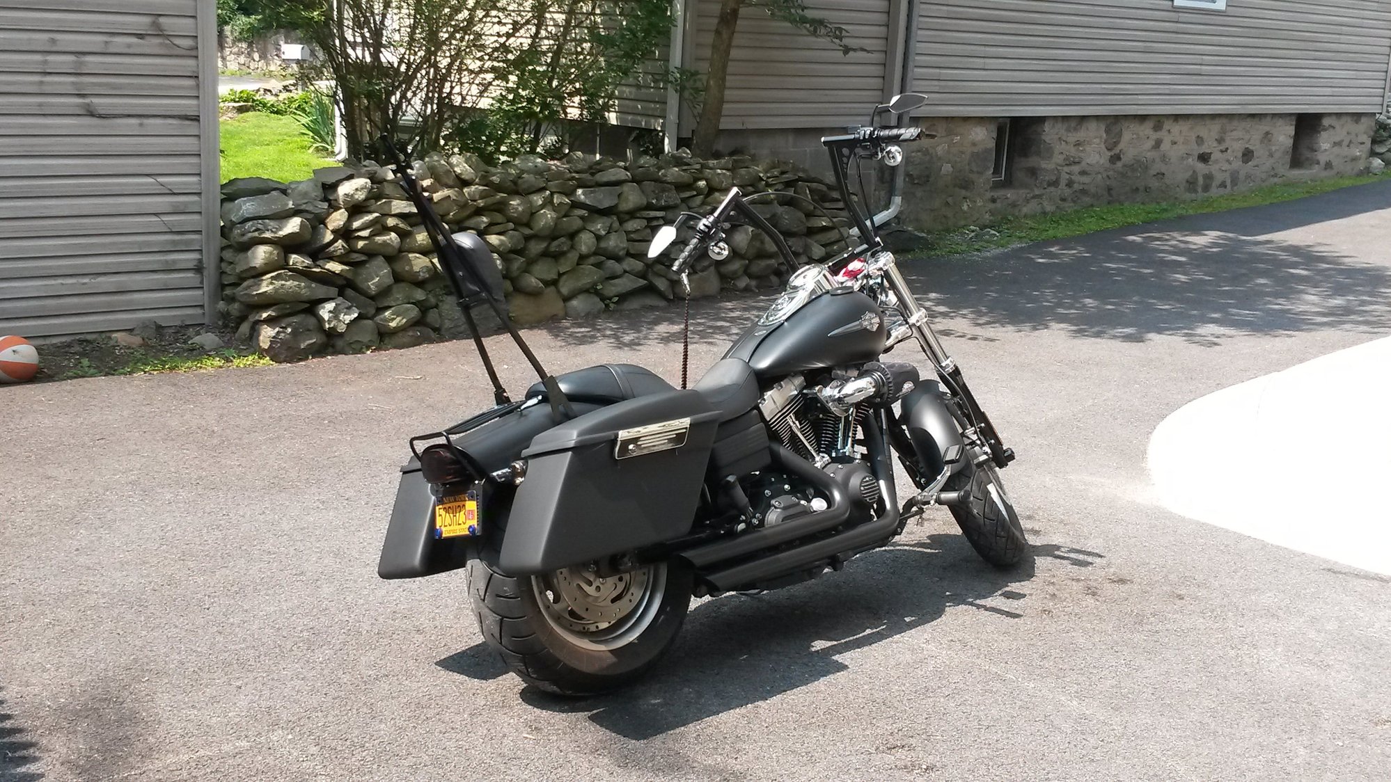

Thanks for all the advice. I ended up going with a custom setup from Magnum Shielding. They look great....and fit perfectly. I could not be happier with the apes!!

For my longer rides....I installed Hardbags over the weekend.

Stands to reason if you're trying to put 14" bars on there WITH risers. +8" seems like that would only get you about halfway there!
BTW - those bars look fuggin SWEEEEEEEEEET!
